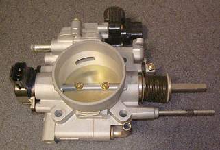

After replacing my seats in my 2002 WRX Wagon, I have been getting a CEL of P0123 (High TPS Value). I used the Xmap software of my Xede to check my TPS readings. They go from 12% with the throttle closed to 80% with WOT. I just replaced the TPS and it has the same values. The values normalize if I turn the TPS sensor counter-clockwise 15 degrees. I looked into the throttle body and it is completely closed when the throttle is off. Any Idea's

Is it possible for the shaft through the the throttle plate to twist. If I were to loosen the 2 screws in the throttle plate would it rotate 10-15 degrees on the shaft?
no it will not.
the shaft is slotted and the butterfly plate fits in the slot.
