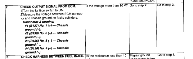

My car threw the following codes: P0302, P0303, and P0340. I was running along at 40-60mph, not starting or revving or anything. The P0340 code indicates the crankshaft position sensor, so I checked it. The resistance between the two sensor pins was perfectly in spec (2K ohms). In fact, I bought a new sensor and the resistance was identical. I cleared the codes and after idling for ~30 seconds the problem came back. Sometimes the problem showed up as just the P030x (cylinder x misfire) codes and sometimes it showed up as P0340 along with P0302 and P0303.
I'm having trouble following the service manual description for the P030x misfires. Specifically, the point where it says "Check output signal from ECM". I checked the voltage drop between connector B137, pin 1 and ground and got 0V. I checked the other cylinders (connector B136, pins 4-6) and got 0V as well. The ignition switch was ON, so I know there should have been power. However I don't think I measured correctly because with 0V it seems like the car wouldn't run at all. The car does run, just very roughly like it's misfiring. I measured the voltage at the connector pin itself and at the ECM, and neither one gave me any voltage for these pins.
Can anyone help me correct how I'm following the service manual? Is there a common cause that people usually see with the P0340 and P030x codes that's not the sensor itself. My car has 21K miles.
