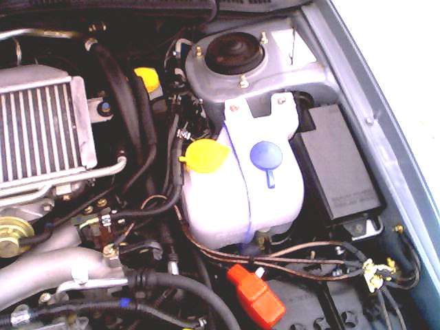

I.C. Spray Mod Complete
I have a wagon so i used the rear pump to spray the I.C. What I did to solve the "where to put the extra resevoir tank" is cut my stock tank in half, silicone a piece of plastic dividing the front windshield washer pump from the now I.C. spray pump. Drilled a hole on I.C. pump side and siliconed a filler cap on the top. Here is the Tank Installed.
