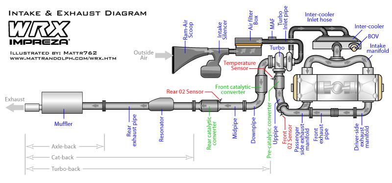

ok........now i'm confused....and my head hurts from thinking.
how many pipes make up the stock exhaust????? and in what order do they go?????? i'm gonna start from scratch so i get this right!
i wanted to get rid of the third cat! that way i'll get the most out of my stage 2. where the hell is the resinator box in the exhaust????
help me out here........
later, riggs
4 total OEM sections starting at the turbo: Downpipe 1 cat, Midpipe 1 cat, Resinator pipe (the long one often confussed for the midpipe), and the finally the axle back.
Most after market Downpipes replace the first 2 sections in ONE PIECE. if you went that route then you'd have 3 total sections.
Eric
Eric
So with that said we'd need to know what type of flange the Flowmaster catback had. Does it mate to the OEM donut gasket of the midpipe or is it flat like the Helix. Take a pic of it or link a picture of YOUR exhaust here so we can help you out.
