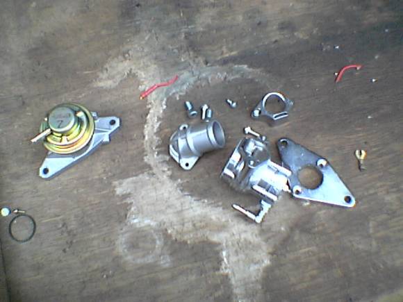

I was bored yesterday, so I decided to convert my Blitz DD BOV to a 100% recirculating type. For those that don't know, the stock bypass valve works fine, this is just for those who want something different. First, I dissassembled the Blitz BOV and the stock valve:

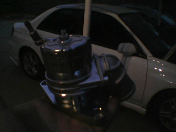

Uhoh, it's getting dark, I better hurry before the monsters come out. Here is the modified BOV on the I/C:
Old Jul 20, 2003 | 01:51 PM
boloheadrat's Avatar
Posts: 1,031
