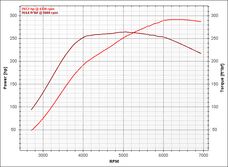

Well, I made the switch from UTEC to EcuTek. Ed with EQTuning did an awesome job. He pulled some strong, consistant numbers. My rex runs smooth all the way to 7,350rpm! Lots of torque! 292.2whp / 264.6 ft lbf.
In case you're wondering, here's a short list of my mods.
vf39
jdm sti injectors
stage II cylinder heads
Walbro fuel pump
cold air intake
catless uppipe
catless turbo-back exhaust
Also running on 96-97 octane

What do "stage II" heads entail? Just port and polish, or cams and valvetrain work? Did you alter the compression ratio?

According to Jeromey, the heads were ported and polished with better valves. AFAIK, the cams and compression ratio remain stock.

BTW... this was with the stock tmic and a custom downpipe that's less than ideal. With a bigger IC and a nice DP this car shouldn't have much trouble breaking 300whp.

how are you running 96 octane daily? nice numbers btw

By mixing pump gas with 100 octane or toluene most likely.

This was a mix pump gas with some 100 as ban suv's said.

Yeah, as stated I mix. I usually mix 75% 100 octane with 91. And this car is not my daily driver. That would be too expensive!

Basic porting and polishing. Exhaust ports enlargened. Intake was also polished and port-matched with the heads. Racing valves with titanium internals. Lots of customizing to the valves along with other stuff I don't quite grasp the understanding! Left the cams alone. That would have been another $1,100 +. Maybe next time when I blow the motor!
