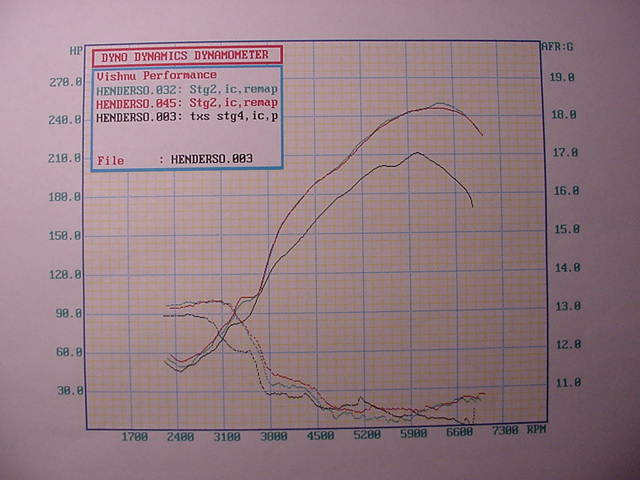

First pic:
Utec stage 4TMIC map(off the shelf) 16psi vs dyno tuned Ecutek 17psi tapers to 11psi by 6500

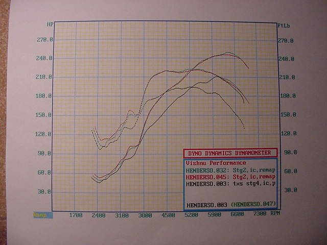

2nd pic:
Utec a/f vs Ecutek a/f
Notice how safe the a/f off the shelf Stage 4 map is. Gets down to 10-1

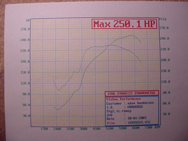

Last pic:
Ecutek hp and torq
The car is just as smooth as stock only with 250whp.
