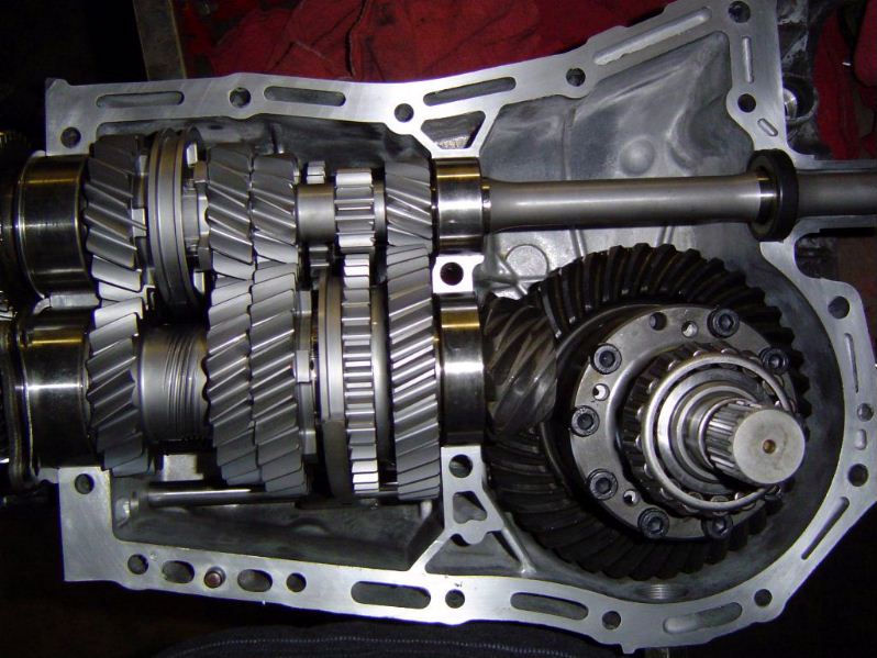

600 ft lbs.......I'd bet this would hold. As for the rest of the drivetrain I don't know.
Andrew@Hillmuth
Attached Thumbnails What Gearbox for over 600ft/lb's.. ?-ppg-dog.jpg
