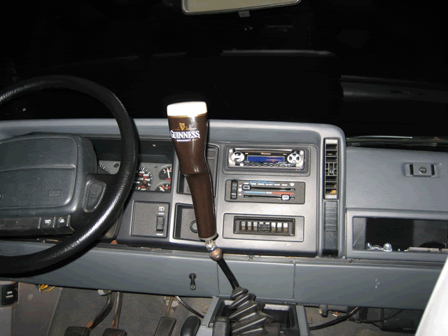

Like this?

Originally Posted by Cody8675309
Like this?
you know, I've thought about using a shift **** as a tap handle, but never the other way around
