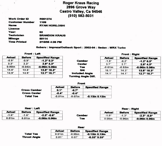

Roger Kraus
I went in looking for:
-1.5 fr
-1.0 rr
zero toe
They informed me when they had it up on the rack that, although specs showed that -1.2 could be had with stock hardware, they were only able to get -1.0 with my car. They asked a bunch of questions about how I drive, what my goal was in terms of how I wanted the car to handle, and gave me a bunch of options and told me what they would recommend.
I ended up staying with stock hardware up front. I have camber bolts on the rear. This is the results:
BEFORE:
Front Left -.9 camber -.04in toe
Front Right -.2 camber -.03in toe
Rear Left -1.8 camber .01 toe
Rear Right -1.3 camber -.06 toe
AFTER:
Front Left -.9 camber zero toe
Front Right -1.0 camber -.01in toe
Rear Left -1.0 camber .01 toe
Rear Right -1.0 camber zero toe
I didn't notice it before the alignment, but the car felt like it was fighting itself as I was driving. Now it handles great and is incredibly neutral.
They took it out twice because after he set it the first time, he said that although the numbers looked right, the car was a "hair off". He tweaked it again and took it for a drive, put it back on the rack, to check the numbers, and then he said he was happy.
I had a great experience with Roger Kraus and would recommend them to anyone.
IMO worth every penny of the ~$120 I paid.
That being said, I have to give props to AI. I showed up after business hours lights were off and they sold me a set of camber bolts no hassles and made sure to warn me not to install them unless I was getting an alignment right after I put them in.
Attached Thumbnails Where to get street performance alignment?-untitled-1.jpg
