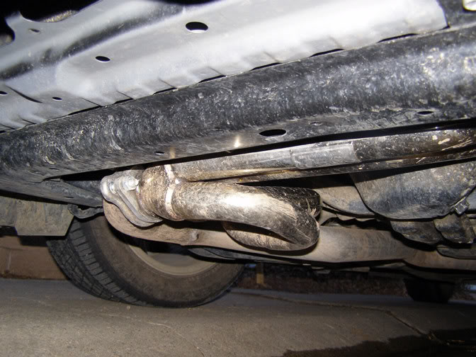

theres not alot out there for you 2.5i guys. I know most just modify WRX headers, attaching the midpipe where the WRX up-pipe would go, like this.
Do a search on the non-turbo section of this forum as well, I know theres a couple posts on there about it as well, g'luck!
