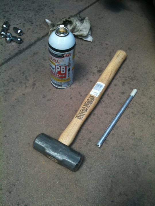

Hmm i bet if you clean the threads before trying to move the 2 rings.
Soak it in freeze off pb w/e you have.
Then try to move the one that's not a lock ring up.
Then try the lock ring again down.
Better yet push them both opposite directions with big pipes in both.
Old Jul 12, 2011 | 04:56 AM
  #51
JourdanWithaU's Avatar
Posts: 19,721

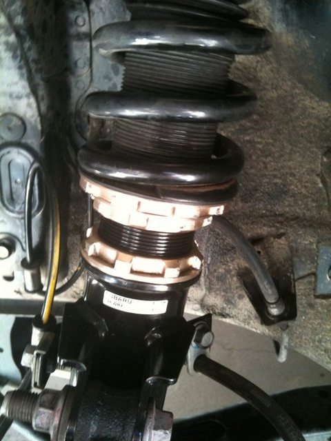

Only one ring... Independent height and preload adjustment.
Ring 2c is the problematic one...
Diagram
From the post where I figured it out...
Got it done!
I think this is the image I had here... Not sure...
Tools that got it done...
PB Blaster
Aluminum Tube
2.5lb Mini Sledge Hammer
Opted for the aluminum tube because we figured that a flat head screw driver would cut into the collar and create more issues. We looked for something more blunt to spread out the force and we found a random little aluminum tube.
The tube lost the battle but won the war.
Before
After
Dropped it about another 1.5". Still a tiny bit of room before the strut hits the CV boot. and the rears are maxed out.
Just high enough to still open the doors.
One ring to rule them all...

I would soak it with liquidwrench or other penetrator. See if there is any give, if not, bake it and try again. And again, and again, and again.
It'll give way eventually.

Got it done!

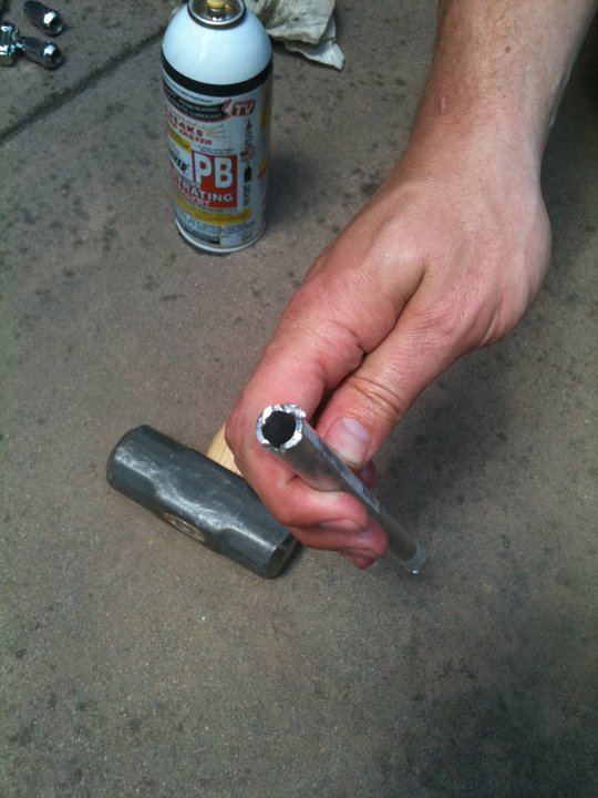

PB Blaster
Aluminum Tube
Before

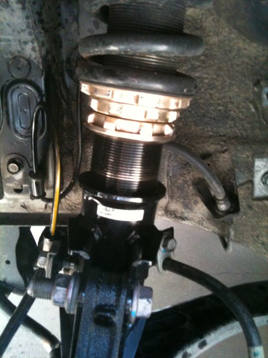

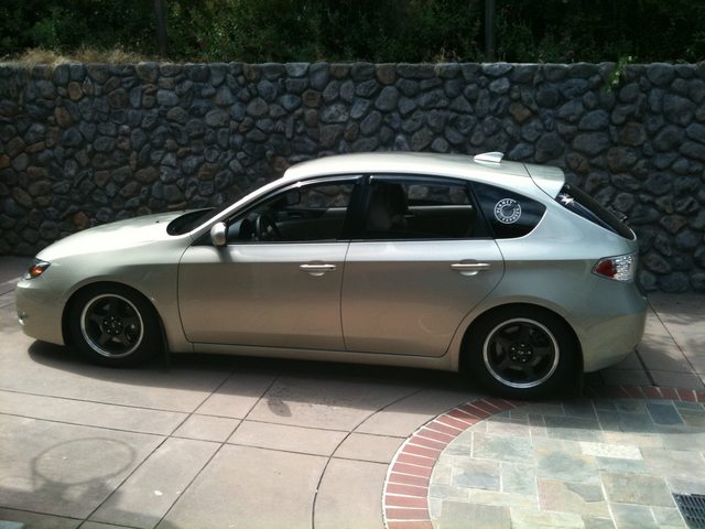

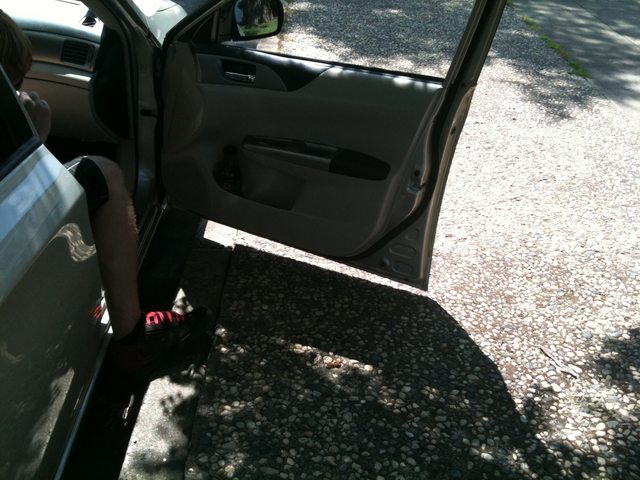

After
