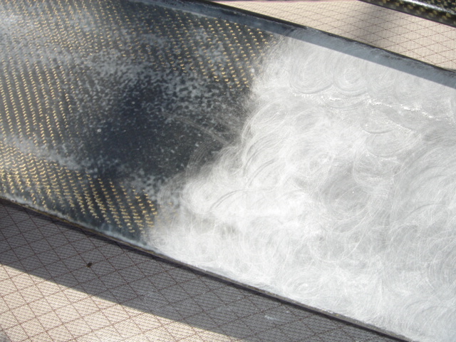

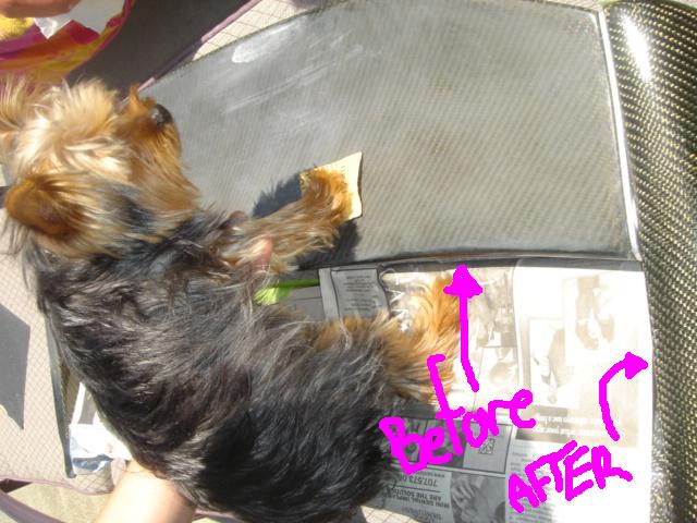

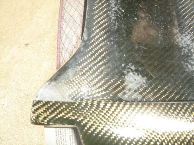

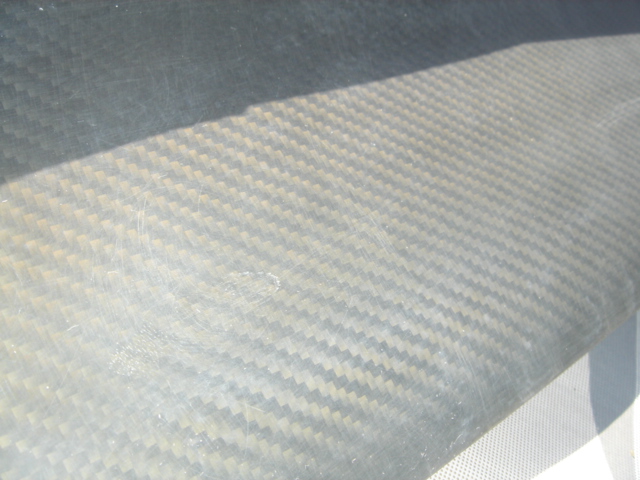

My friend and i re-clear coated his cf wing, and we used 350 then just clear coated it with like 4 layers. here are some pictures.

exactly

Wow. That looks like a huge improvement. I don't want to mess up my hood, but that'd be nice. The light sanding should also be able to eliminate the tree sap, racoon prints, and the wax crayon thingy on my hood.
Maybe I could do a test run on one of my vents or something. If something goes wrong, it wouldn't be that expensive to replace.

just make sure not to sand to far down you don't want to mess up the beautiful cf. when you are doing it it will look like complete $h*t but after you spray the first layer of clear coat it will takes its beauty back lol.
