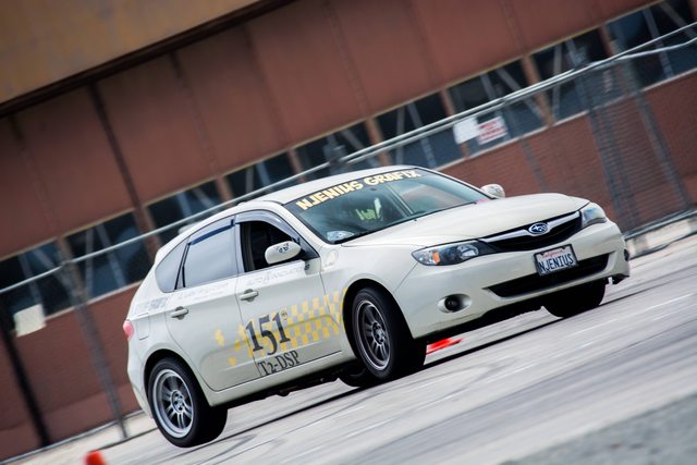

The ice water helped a lot. Much better time than last month.
I also found out that Alvin takes awesome photos.
Sometimes, I love that i-club doesn't re-size images.

^ Of course the water helped, and my best pics have come from Alvin and Jansen.

Welcome to Dunlop ownership...
