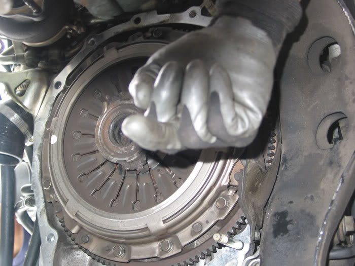

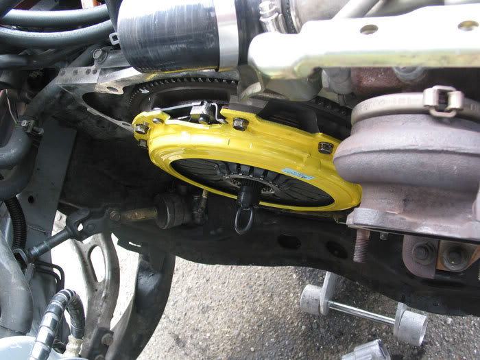

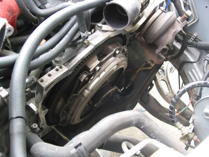

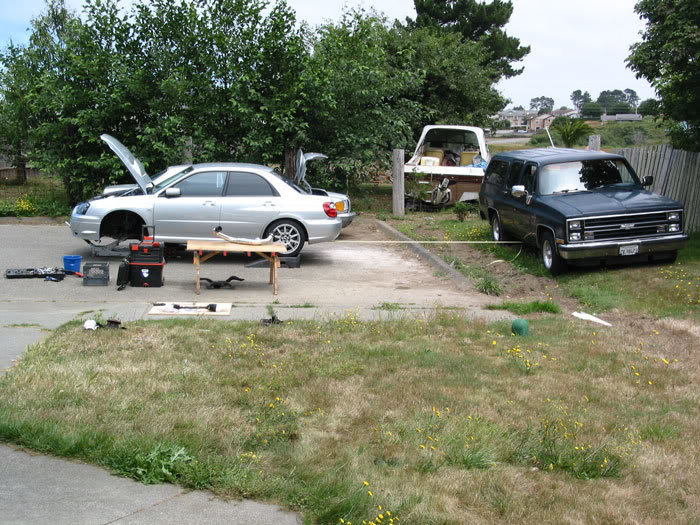

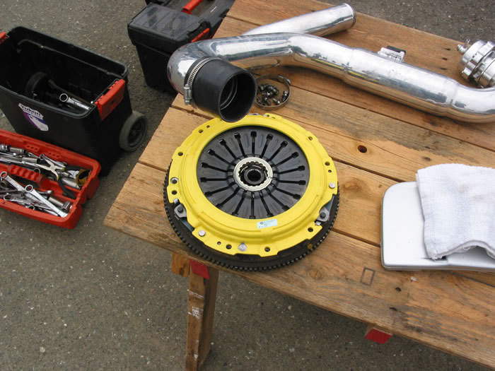

Fast forward a week later. Clutch is here. I source the Subaru man ul for my car (3,048 pages!). I have never changed a clutch before but figured it was time I learn. I enlist my cool *** neighbor Damien and give him as much cash as I could spare to help me out. He agrees willingly not knowing full well what he is getting into (neither did I). So we figure we have all day Sat and we will get it done. Hahaha not so much. This is an AWD car and you have two rookies that have to triple check everything in the manual and then re-check it once more.
Sat, Sun, and part of Monday. Finally the clutch was in. We only broke one thing. I also found a bunch of exhaust leaks and fixed them.

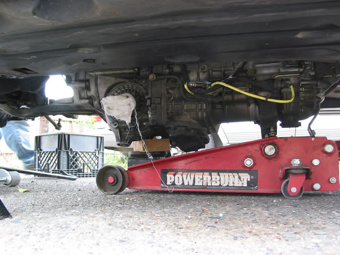

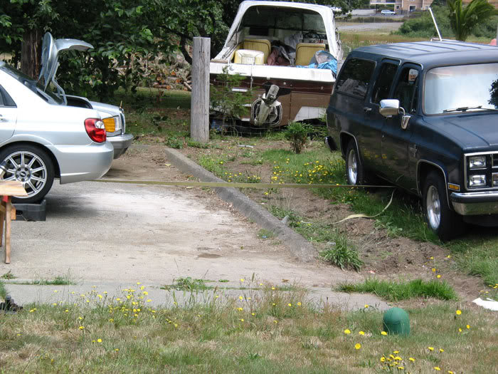

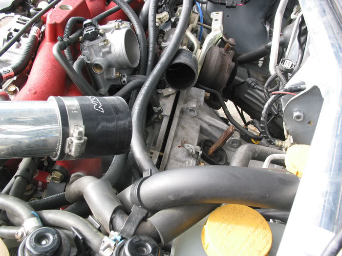

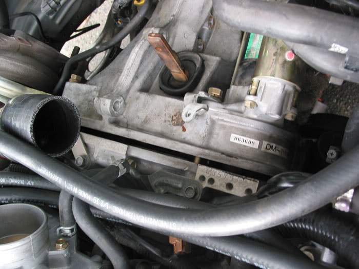

Once we got all the bolts off the tranny and released the the fork we could not pry that tranny off the motor. Stumped and frustrated we came up with this! And it worked right away! hahaha

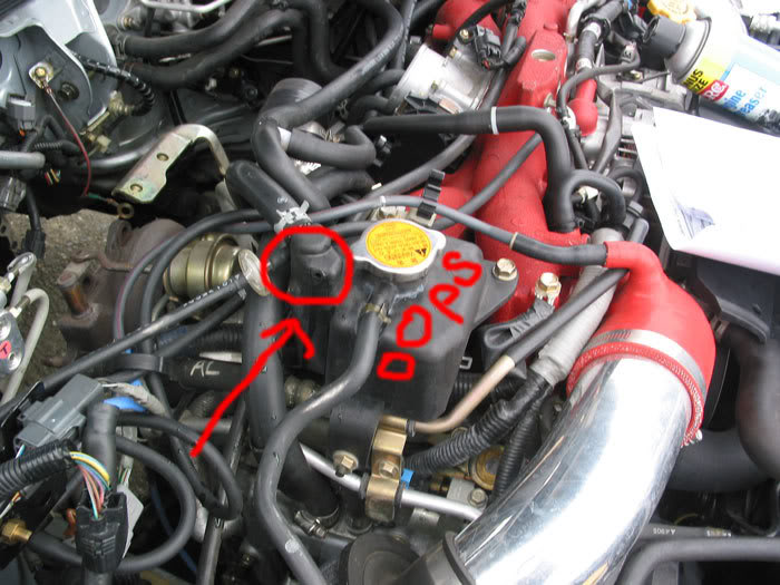

Um oops, we broke off the nipple for the turbo coolant res. Ouch.

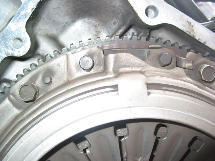

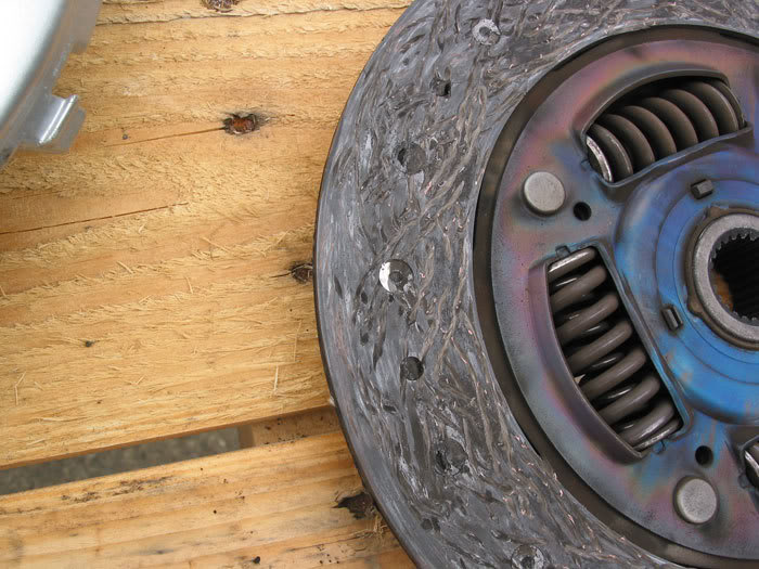

Stock Exedy clutch
I was down to the recessed alan heads on the metal disc!

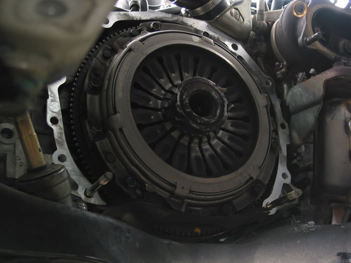

Stock clutch, pressure plate, and flywheel. 48k and hammered from beating it up at above stock power.

Damien the man!
Jose and Damien. Jose came to help with putting the tranny back up as it took two guys underneath the car, each with a jack under the tranny and one on top pulling it. WOW.
Cliffs: I has ACT 6 puck unsprung and I is going to the dynos Saturday @ 2pm for more powers!

****in Classic Shade Tree FTW!!!

why no aftermarket flywheel with all that off and the hook up on the clutch?
Props for going at that by yourself. It's quite an undertaking without a lift and experience.
I was told by a few people and with some reading that the stocker resurfaced was the way to go for the setup I am trying to achieve. the last piece of the puzzle is the FP GReen V2 that I need to buy. I will try the turbo install myself after accomplishing this feat.

I borrowed a coolant res from a local guy with his car down this week so I can break in the clutch before the dyno Sat. As soon as the res Paul sent me comes I still have to swap it out again, or maybe I will just give him the new one and call it good.
