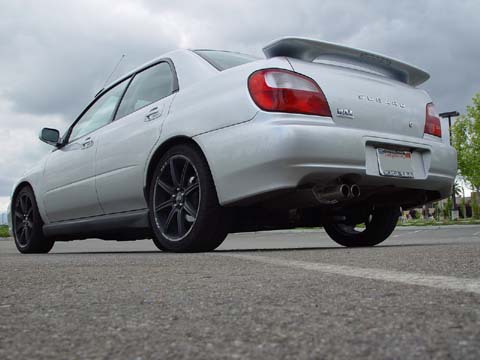

I have 18's and I have the Tein S.Tech springs..... -2.0" front drop, -.7" rear drop...... No rubbing, not even remotely close....but make sure your rims are the proper offset for your car, or rubbing MAY be a problem. I believe my offset is about 45 or so.....I dont totally remember.
and YES.....YOUR CAR WILL SETTLE A BIT AFTER LOWERING IT.....
See my lowering suspension issues Here
For the record......My car DID settle down into an EVEN STANCE, and it took a month or more to totally settle.
Mine actually is about -2" front drop, and a little over -1.0" drop rear after settling.
Yes, you will need a 4 wheel alignment after your lower it.....and you SHOULD do it SOON after your car is lowered....

Old Nov 24, 2003 | 03:51 PM
GotBoost?'s Avatar
Posts: 3,648
Car Info: 2003 PSM STi
Here's a pic of my car lowered with 18's
-Ted
