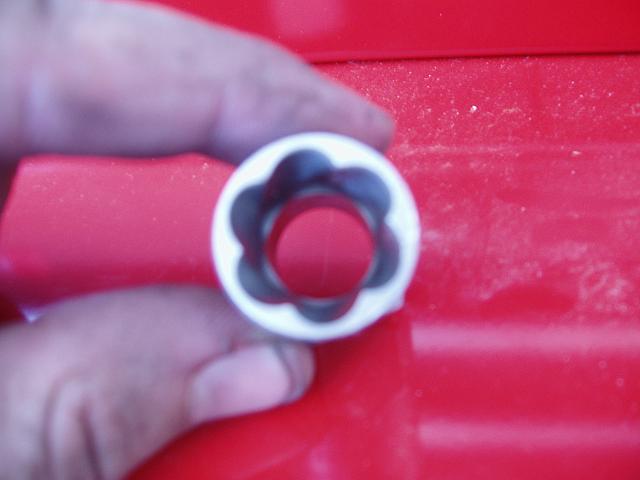

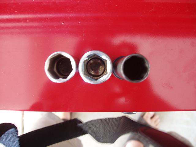

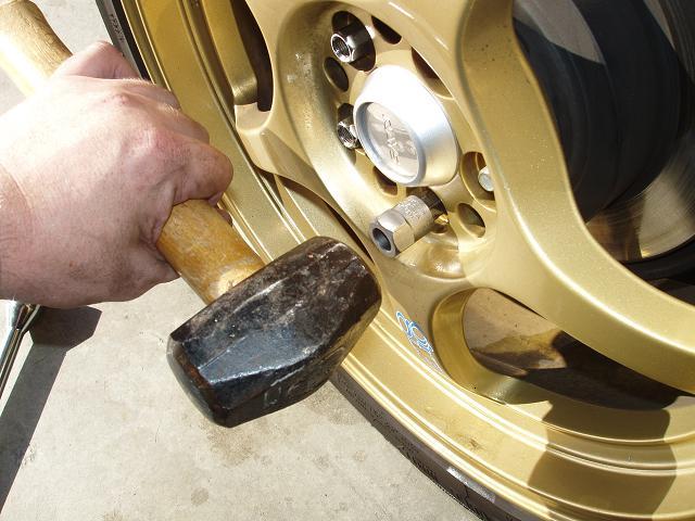

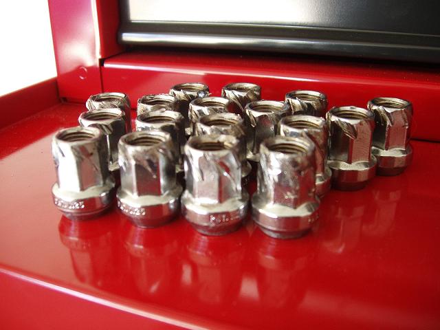

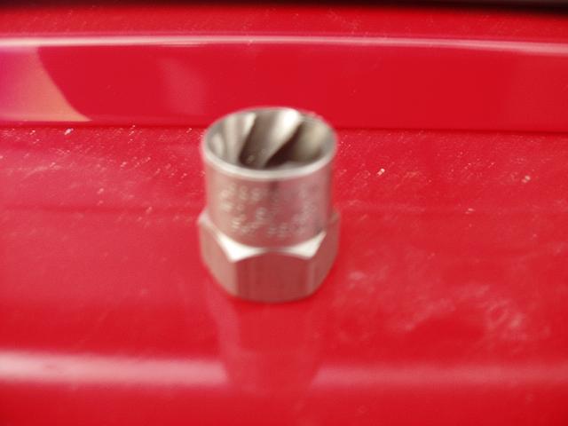

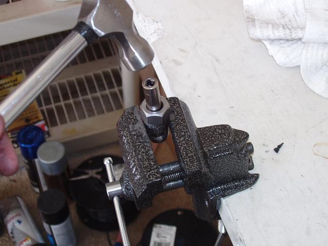

Well i finally got the stubborn bastards off and wanted to bump this thread incase anyone happened to have the same problem as myself.
Anyway, I used the #10bolt off tool from craftsman, and a mallet to drive it onto each lug. It eats them off like nothing but you'll need a vice or something similar to get the old lug out of the #10 tool with a punch.
Other than that here's a picture collage of what i did because im too lazy to write it all out. You can basically figure out how to do it with the pics.
Attached Thumbnails Kyokugen blows (need help)-1.jpg   Kyokugen blows (need help)-2.jpg   Kyokugen blows (need help)-3.jpg
Old Jun 19, 2004 | 01:02 PM
Salty's Avatar
Posts: 8,675
From: Wherever Sucks the Most
The first two pics are pretty straight forward. The last pic compares the two Rays Duralug keys (6sided socket and their 7sided locking key) on the left to the flimsy POS "butter alloy" kyokugen socket to the right.
Notice how beefy the rays are...

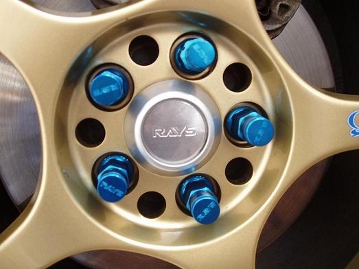

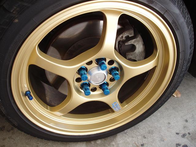

Finally the Rays Duralugs installed!
Attached Thumbnails Kyokugen blows (need help)-7.jpg   Kyokugen blows (need help)-8.jpg
