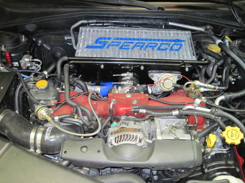

sold it along time ago. it was the GMS. heres the current setup. hands down the best. spearco,cobb,dw740 ect. makes good power. plus the spearco fits so much better. ive had knockoffs,APS and modded stock sti.

I've wanted a spearco since I seen Chris's STi when he worked at EQ, nice setup! Like the black intake hoses better too, more stealthy looking.

looks like to ssac/ turbo xs or the speirco
Old Mar 17, 2011 | 01:07 PM
  #891
04caliwrx's Avatar
Posts: 9,581
haha looks like i guessed correct after u posted it up
