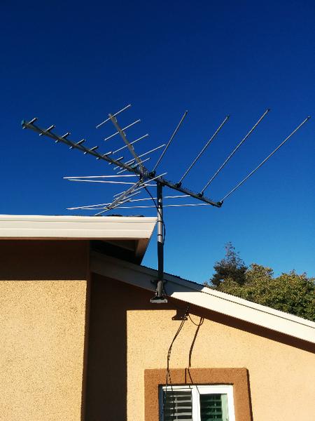

Attachment 89178
Here it is. Pointing ( that's the left side) towards Sutro. I get all the major networks and I get great signal without the preamp.

I wasn't getting KQEH 54.1-54.5 (real channel 50) very well of the backside of my CM3016 antenna. I replaced the transformer last week since I know it was corroded pretty badly, but that did not help.

So this past weekend I got up there and saw that I aimed the antenna a little south of Sutro (right side there) and that made the back end (to the left there) aimed north of Mt Allison (Mission Peak Area).
So I loosened it up, and raised nearly the very top of the mast, and turned it a little north of sutro tower, and that put the back end nearly directly at Mt. Allison.
This fixed my KQEH issue, which is great cause 54.4 is the PBS Kids channel. When my wife and I are cooking dinner we can throw that on and it always always has some kids program for my daughter to watch. Not only that but, IMHO, better than kids programming on Nick Jr or Disney Jr.
Next what I did was put in another 4 way splitter at the cable junction box (one is already up near the antenna).
Well, everything after that 2nd splitter doesn't get 54.4 very well, so that tells me the 7db loss through that splitter is enough to kill the signal.
So I'll be installing a preamp at the mast this weekend, and powering from the gym where I have my "old" 42" Vizio mounted up.
I hope that this will get all my signals nice and strong again, but hopefully not too strong to where the really strong channels get over loaded.
We shall see.
Happy Cable Cutting!
