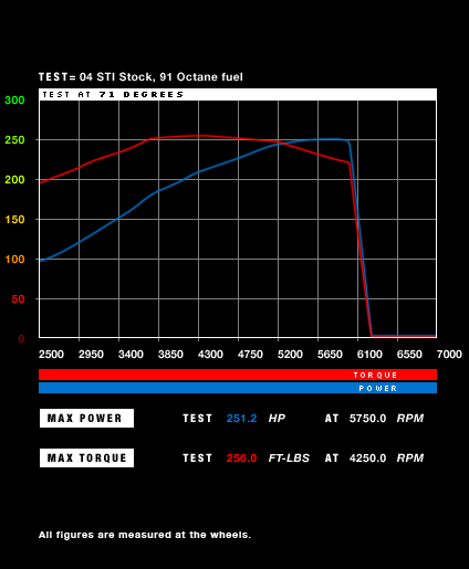

Interesting.
This is from FLI's Mustang Dyno. I have found it low reading compared to most.

Interesting.
FWIW, I believe FLI has their Mustang calibrated just like Cobb's and at this calibration they tend to read more like Dynojets. The other Mustangs I've seen like GST's, Gruppe-S, Innovative, EFI Logics, etc tend to read about 15-16% lower.
Our own dyno in its normal state reads more like a Dynojet as well, but I run a .85 correction factor to make the numbers consistent with my road dyno software that I had been using for many years. The road dyno software always read very similarly to the lower reading Mustang dynos and I have gotten used to dealing with those numbers.
Either way, this is in no way about "right" or "wrong". Every dyno will read differently depending on hardware, software, conditions, and calibration. Dyno's are just tuning tools, so as long as you have an accurate baseline to work from, it doesn't matter if the dyno reads high or low... the % delta will always be the same.
