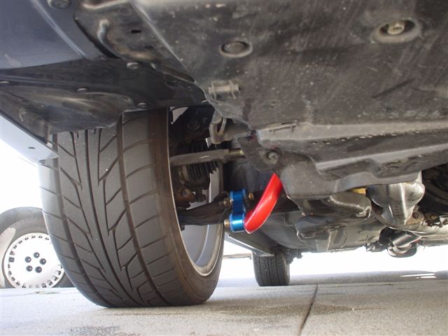

filice g got a question for u on ur install
after installing my ducts i put the wider/deeper part forward towards the bumper hole. the parts are handed and when I installed mine the duct exited more towards the inside of the tire not towards the tread like it looks in urs. If u flip them around i think you will see what i mean hope this helps.
