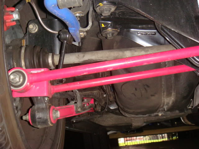

Old May 12, 2008 | 03:15 PM
Racenut's Avatar
Posts: 1,138
From: Monterey Bay, Ca
Car Info: WR Blue Wagon
Before
After

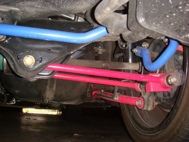

LOL BLUE20 is posting that picture of kevin sister every AUDT thread LOL
here is the sti conversion
