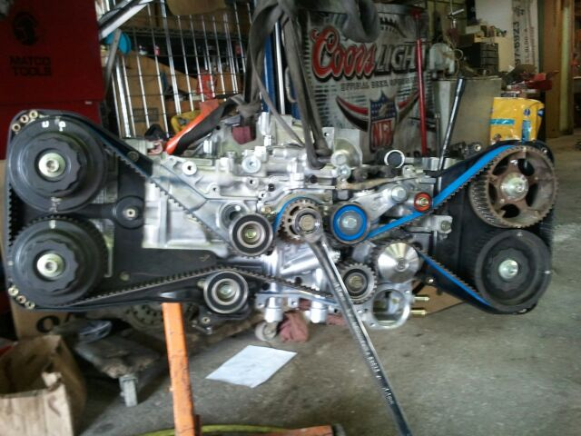

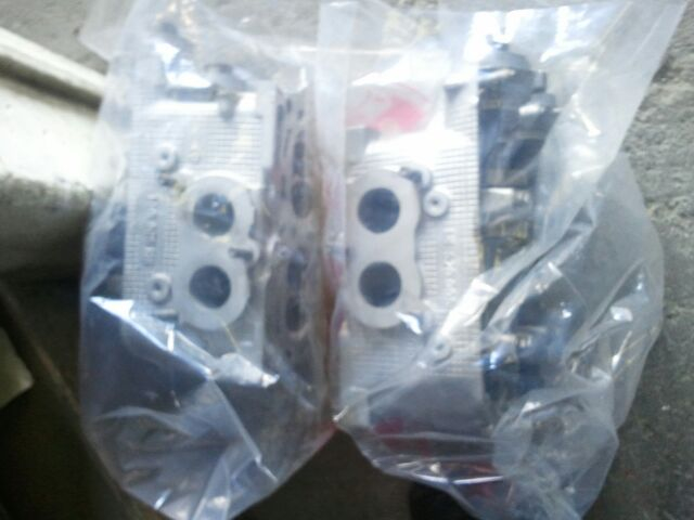

Update bump
Attached Thumbnails am i going backwards?-image-1087131713.jpg   am i going backwards?-image-3194535184.jpg

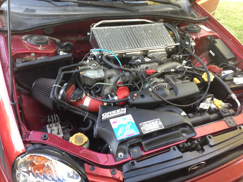

Update the car is completed!!
Video up soon
The car runs but my idle is a lot higher
