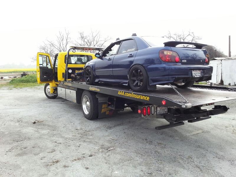

lol. great. ill deff keep that in mind. but unfortunately, project RSTI wuikll have to be put on temporary hold.
blown headgasket/overheated

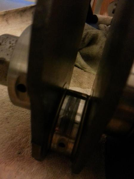

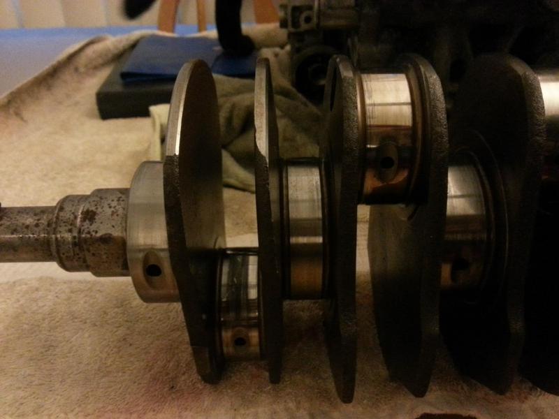

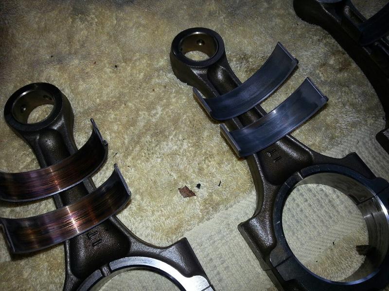

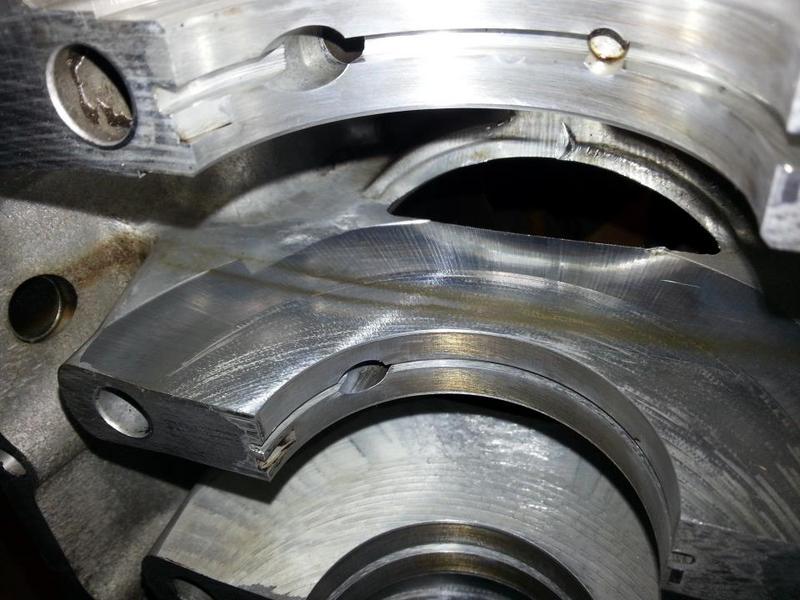

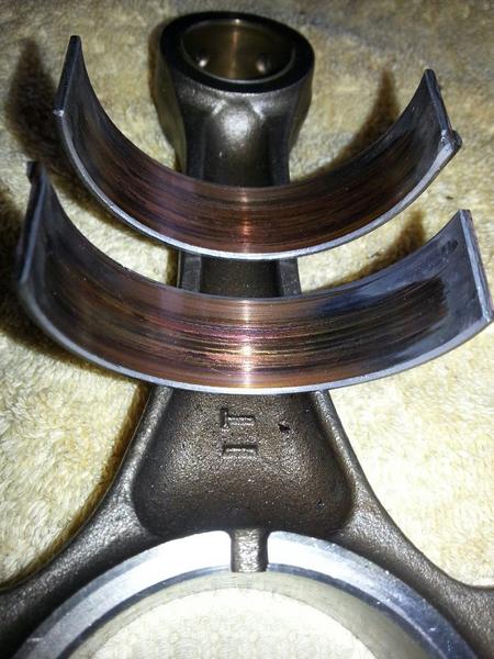

I did a little cleaning and quick visual inspection along with started measuring the crankshaft last night. I still need to finish gathering up all the measurements, but there are a few things i wanted to ask the general consensus about.
#1 rod journal/bearing has some sever marks. the bearing that were pulled off the rod were a blueigh/purple haze. I suspected overheating of the bearing. Also note, that what seems to be a crack is a scratch mark of some sort.
Attachment 81417
Attachment 81418
Rear main bearing and journal. minor wear and tear. but not nearly as bad as #1 rod bearing!

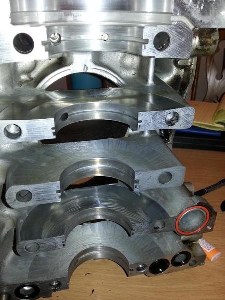

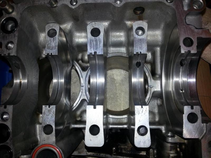

Notice the pitting on the bottom of the cylinder walls. would a worn main/rod bearing cause the piston to travel low enough for the skirt to make contact??
Edit: the pistons are on the other side...*sigh* LOL. so, crank walk would cause a nick like that?
I just dont know what this scorch mark is. pinging? detonation? could detonation explain the bearing on #1?
For those of you who have rebuilt Subaru blocks, what steps am I looking at now? will a good machining/polishing on the crankshaft do the trick? or should i buy brand new. I also have another used crankshaft awaiting for me to pick up (thanks to JavaBlck)
Will the nicks at the bottom of the cylinder walls compromise the integrity of the block?
Any input is appreciated. thanks!

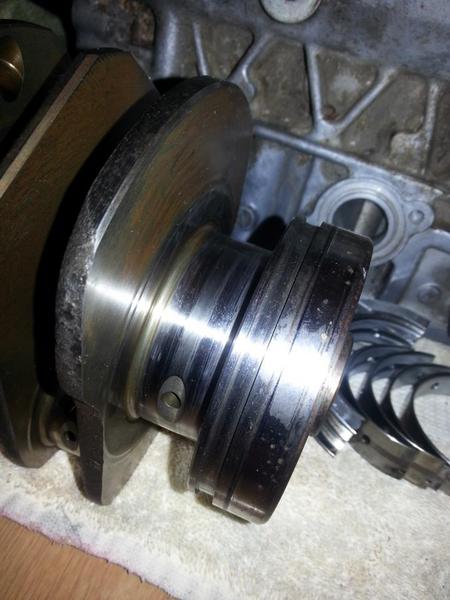

the #1 rod bearing and journals that didnt load:
