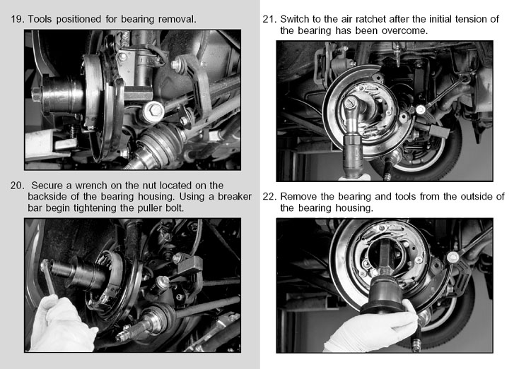

Here's the official word...hope this can be of some assistance...
In the official procedure they use a puller bolt and these are the final steps. If you need the previous or subsequent steps let me know.
I got that from techinfo.subaru.com
You pay $20 and you get 72 hours to download anything you possibly can. I got the tech manual for my WRX and I happened to pick up a copy of the wheel bearing installation manual which is where I got the picture I posted.
Its a pain in the @ss to collect a complete manual because they post it one page at a time, but the price is right.
