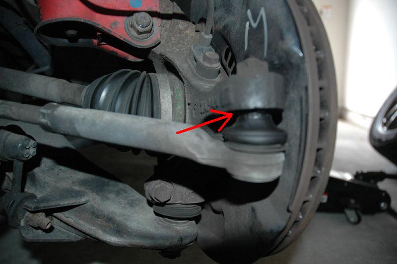

I have some new information. I took off the front tires and did some looking around at the tie rod ends and found some interesting stuff. First off, I could tell that they adjusted the driver's side tie rod when I got it alligned. That's good news since it means that my toe probably was out and that might be the whole problem. However, when I was inspecting where the tie rod end connects to the wheel assembly, I noticed that there was some grease coming out from the boot around the tie rod end. Of course, they are non-greaseable tie rod ends, so I can't just re-grease it. The driver's side was the only one that was leaking grease, but I could pull both boots down a little to see the actual tie rod end shaft underneath. I think the boots are only to keep dirt off the tie rod end and not so much for lubrication.
My questions are, should I replace the boots on the tie rod ends, can I replace the boots, how easy is it to replace them?
Thanks for the help and the long read.
psycho
Attached Thumbnails Uneven tire wear!!!-tie-rod-end-001-edit.jpg   Uneven tire wear!!!-tie-rod-end-003-edit.jpg
