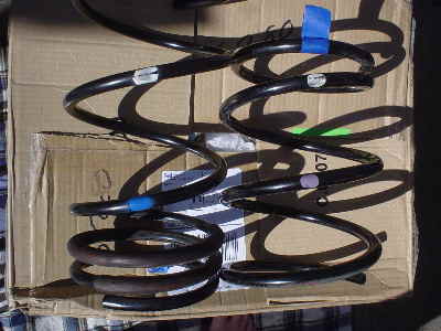

I thought the paint code was the same, after looking at it again, one of the dots on the front spring is more of a purple color.
So are these different?
Yeah, the one on the left is the same blue as mine, the right one looks purple.
