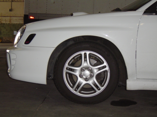

Here is that pic. I have individual shots of front and rear if you want to see them.

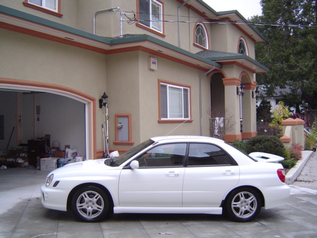

if u just plan on upgrading with springs, stick with something that is nowhere near 2 inch drop. 1.5 is the most i'd go with. heres a picture of the eibachs on stock struts.
