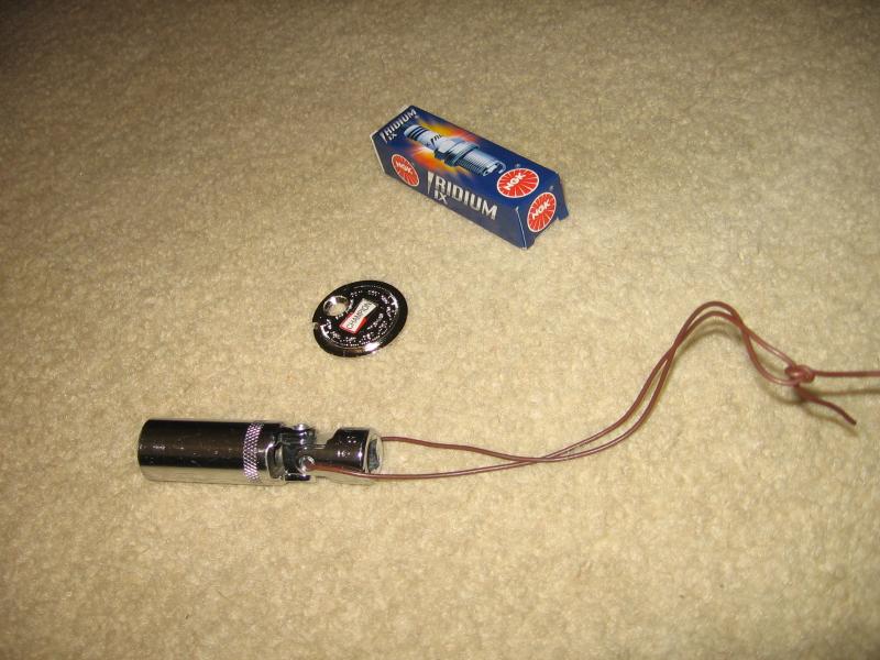

Some of the tools necessary for spark plug replacement:
four (4) new spark plugs
3/8"-drive metric socket set
3/8"-drive ratchet (fine tooth works best)
3/8"-drive spark plug socket with integrated u-joint
various length 3/8"-drive extensions
large slotted screwdriver to loosen hose clamps
spark plug gapping gauge and adjustment tool
torque wrench
Factory spark plugs for the 2002 model year WRX is the NGK PFR6G. I used NGK Iridium spark plugs one step colder than the factory plugs, number BKR7EIX.
Note the 16 or 18 gauge electrical wire inserted through the spark plug socket pivot pin for the u-joint. A good spark plug socket has a rubber insert to positively retain the spark plug inside of the socket. Unfortunately, the socket will sometimes get stuck on the spark plug after you install the new one and it pops loose from the ratchet or extension when you pull on it. The wire allows you to simply pull out the socket for easy retrieval.
This Champion spark plug gapping tool is only good for checking plug gap, not for adjustment (I will upload an image of a decent gapping tool as time permits). Do not pound on the side electrode to close down the gap.
Proper gap as specified by the factory manual is .028" to .031". Spark plug gap must be checked prior to installation! I found the plug gaps on an already installed set to be .034" to .035", which may cause a high-speed misfire under load.
