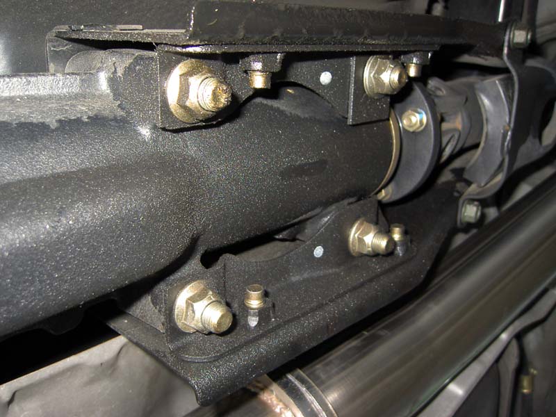

Last week I had an exhaust installed and the guy installing it told me I had a leak from my "half-shafts" in the rear.
Well I crawled under the car today and took a look.
It's not coming from the axle boots like I originally thought, but from somewhere around where the driveshaft meets the rear-end.
(See pics below)
Any Ideas where this leak is specifically coming from?
What do I need to do to stop it?
Thanks in advance.

U-Joint maybe? Where the driveshaft goes into the rear-end there is a seal after the u-joint. between where the actual yoke attaches, at least thats what i can remember.
Just my two-cents.
Just my two-cents.

Can't say anything for sure but you could have a problem with the rear viscious cupling on the rear differential leaking fluid.
I suppose you could check the fluid levels or have them checked at a shop that does changes.
If you can have it looked at right away i can't imagine the impact of low oil on the rear diff but it can't be good in the short run or long run.

Originally Posted by TastyTurbo
Turns out it's the front seal on the rear diff.
Dealer decided to replace the whole differential.
"It's easier".
TT
"It's easier".
TT

I'd just replace the seal. But of course it's labor intensive removing the driveline and pinion yoke, and you might have to redo your backlash. But then again it's me. R&R is sometime the best way to go though too. I'm just thinking in terms of price. Good luck TT.
