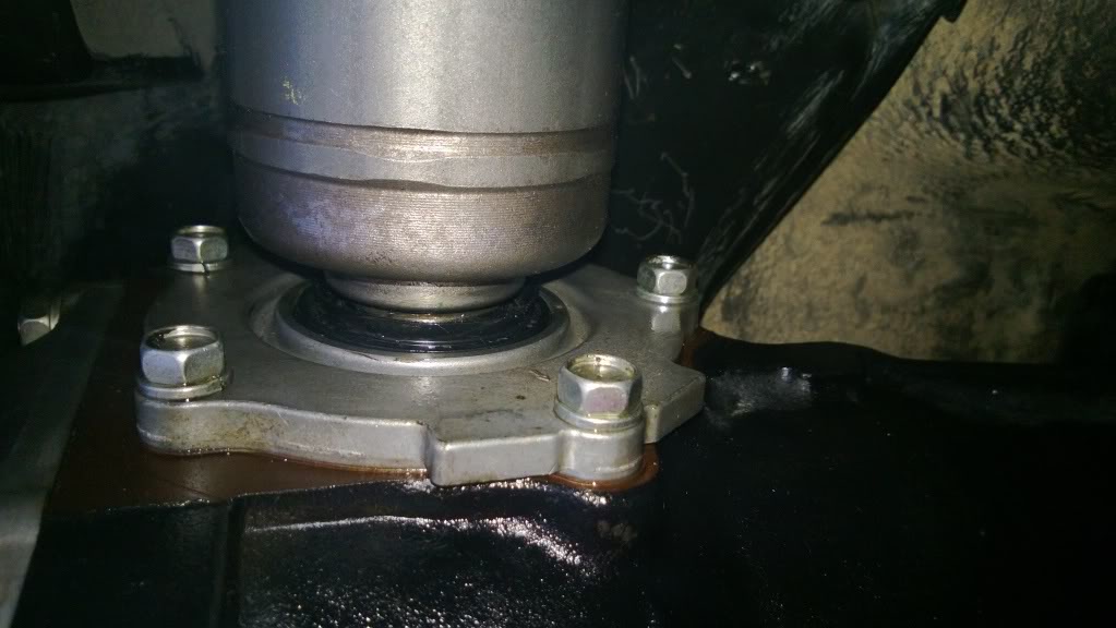

I just recently learned that NON-Subaru remans often dont come with the little metal cup that fits over the seal in the transmission or rear diff.
This is what an OEM axle looks like barely pulled out. Notice the blackish metal "cup":
Had I known I would have either tried to remove the old ones without damage or I would have sourced a set that had that metal cup. The legacy will see quite a bit of gravel/dirt roads so I might be replacing the axles sooner than if I went with ones that had cover the seal.
