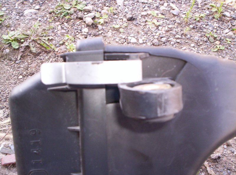

yes subaru box,
this is the best picture I have of it at the moment.
Notice how the mounting tab on the right side of the air box is 'drooping' and the clip is at an odd angel. The entire aria around that tab and where the clip is sacured to the box was broken off. It broke clean so there are no little gaps or multipul pieces.
I will take a better picture of the damage when i get home today.

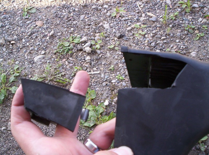

here are good pictures of the damage.
The seller clames that this product was fine when it left his house...
you tell me

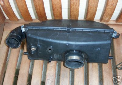

does it look like from the pictures that the product was damaged before it left the seller. the sellers picture is posted above and mine below... I am sure that it was broken before he sent it... tush why he posted this angle.. He sent me an email all mad that i left negitive feedback.

If you are stuck with this air box, you might be able to repair it but it won't be pretty. That retaining clip makes it difficult to effect a long-term repair with epoxy because that area will be in constant tension when the clip is locked down.
Whatever compound you end up trying, you'll have to make sure the area is free of dust and oil and moisture before applying the stuff.
If the joint fails after you've glued it back together, you might try to build up the area with a thin layer of epoxy along the outside and inside of the broken area so that the epoxy can work with a larger surface area.
