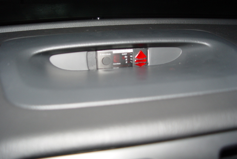

I have a Valentine 1 and with it I got the remote display, I didn't like advertising to the folks behind me that I had a radar detector and what it was doing. The problem was where to install the remote display so that it didn't stick out like a sore thumb.
The solution, remove the clock and put the display in where the clock was, (the green face looks like crap anyways with the other gauges all done in red for the 2005 sti.)
Just pull out the clock holder from the dash, remove the clock from the dashboard piece, put the remote display in there, wire it up and you're done.
It even matches the rest of the dash at night and it's not really visible from behind.

Wow, great job, I am considering moving my V-1 to that spot from right above the rear view mirror now, that is a really cool setup.

I put my display right in front of the parking lamp switch on the steering column. For mine only I can see mine and the passenger, where is your main unit? Mine is hard to see:
http://www.scoobymods.com/forums/showthread.php?t=2121

Nice, good idea. Looks good.

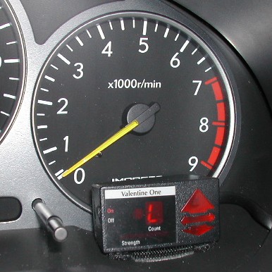

Here's what I did with mine, this was only possible because I had the older style display unit without the control **** and it's small enough to fit inside the cluster-

I had mine on top of the steering wheel in the center before but it stuck out like a sore thumb. With the smaller display off to the side like that it looks nice. I didn't even know they made a display like that, it's actually pretty neat because it's so small.

I have the original remote display which has not been available for some time. In case it isn't obvious to you from the pic, I have it mounted INSIDE the instrument cluster, behind the clear plastic cover.
I have the same old style remote (got my V1 in 92') I've also painted everything black except the arrows so it's a little harder to see. When I had it in my RS I got a dash bezel and used a Dremel an in-set it to that:

Wow, the lower pictures have a newer remote display, is there a mute button??? I'm going to head over the the V1 website and check out the specs. I need to have the mute button near my finger, so my remote display is right above the stereo to the left of the cup holder...

If you want a remote mute button, you can get the remote audio unit from Valentine which has the control **** and switch. I have one, and I remoted the control part and mounted it in the switch blank in the center console (sorry no pic), so all I have to do to mute the V1 is reach down and hit the button.
