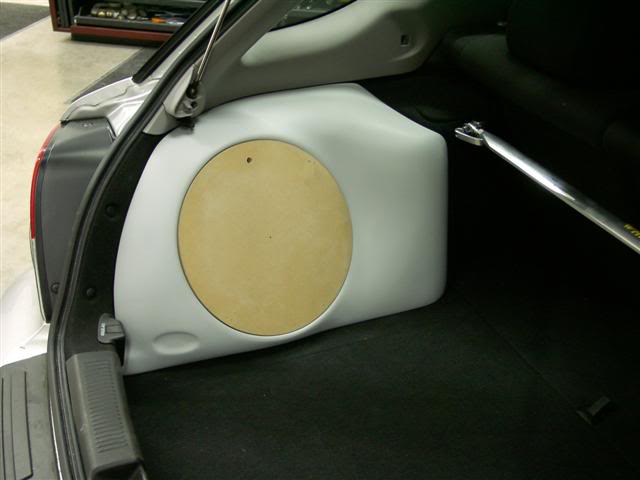

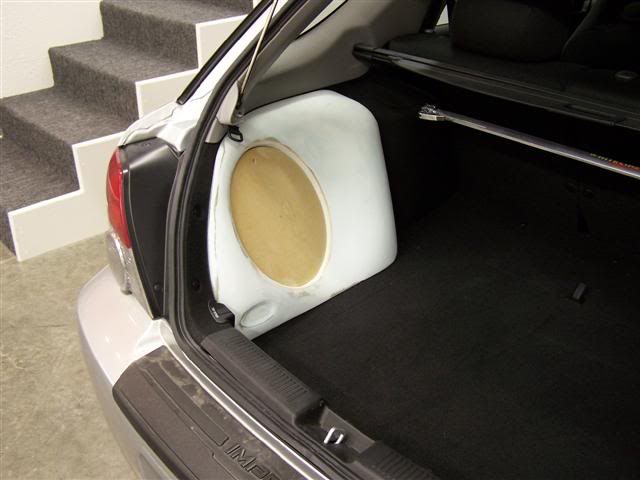

We're in the process of designing and building some fiberglass boxes for WRX/STI sedans and wagons. The biggest problem with the W7 is it so damn deep. To get a box to fit it most of the other woofers would have too much air, plus the design/shape goes all to hell when you have to come out so far. Here's some pics of the originals, a 10 and 12 inch for the WRX/STI sedans and then a 10 and 12 model for the wagons as well.
I used to install for a shop and just recently opened my own doing only custom work and I think JL Audio makes great woofers. I've installed a ton of them from the W0's to the W7's and I used to rock 6 10 W6's in my old car but I think the W7 is a little over rated for the price. These models were designed for Diamond Audio's D6,D3, and D1 subwoofers since that's one of the companies I carry. The D6 woofer is 6.2 inches so fitting a W7 probably won't work. If I find there's a huge need for them I might make a deeper model.
Remember what ever woofer you use it's only going to sound as good as the box it's in. When dealing with a woofer as massive as the W7 I would expect to pay a pretty penny for a good box. It has to be strong as hell or it could sound like crap and might just blow apart. I've built them out of 1 inch mdf with a ton of bracing before, I've even used two layers of 3/4 mdf to construct them from. If any part of the enclosure flex's just a bit it takes energy/volume away from the sub. It has to be strong!!
Just thought I would throw my two cents in the mix.

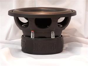

Sounds like you know JL pretty well so here's a couple pics of Diamonds D3 and D6 woofers. Hope this helps!
Size:  9.6 KB Name:  d610s.jpg
Diamond Audio D6
Size:  8.9 KB Name:  d310s.jpg
Size:  8.2 KB Name:  d310b.jpg
Diamond Audio D3

The D9's are their top of the line. Great speakers, but expensive. The D6 10 needs .625 cubes, D3 needs .75 I played around with different locations and found either side sounded good. If you were to move the box around and listen you would have a hard time telling much of a difference. You shouldn't have a problem getting the proper amount of airspace. My 12 inch model is around 1.2 to 1.3 and the 10 inch model is close to .7 to .8 so you should be good.
