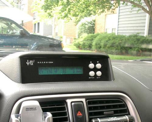

Old Sep 12, 2004 | 06:20 PM
treboo's Avatar
Posts: 11
hi
i need something like this one, sorry for useing somebody's picture
