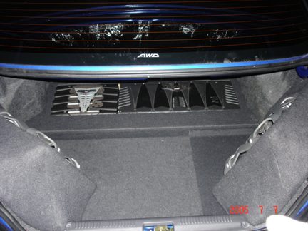

Old Jul 13, 2005 | 04:46 PM
nosnam's Avatar
Posts: 241
From: Donora, PA
Car Info: 2003 subaru
fiberglassing 101

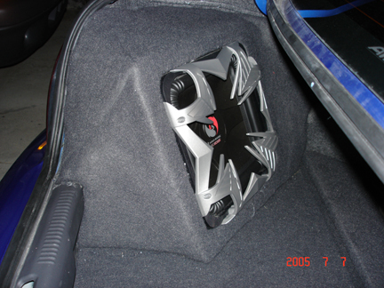

http://web.njit.edu/~cas1383/proj/main/
that is where I learned to do mine, not that hard but I read where some people say it took them about a month to do and I said eh, I can do mine in a weekends, and a month later I finished it.
Attached Thumbnails enclosure questions??-full.jpg   enclosure questions??-sub.jpg

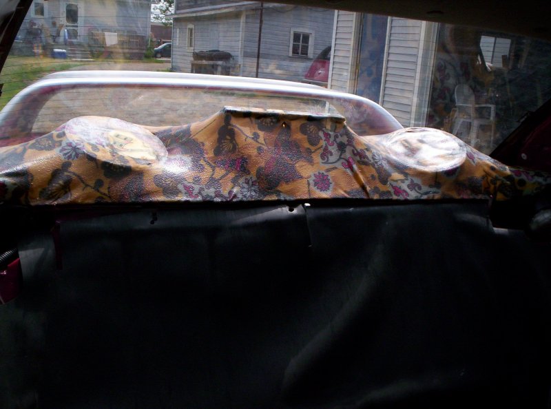

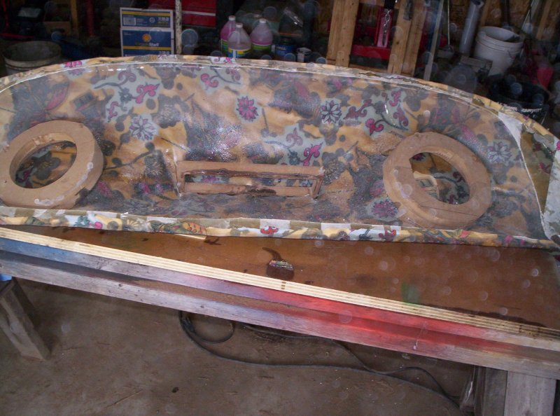

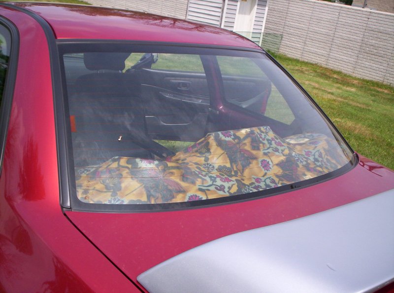

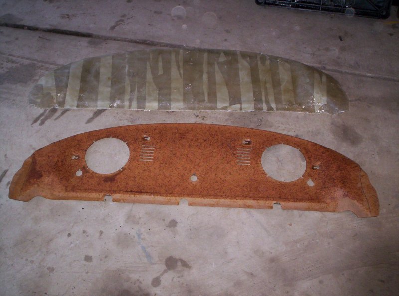

well guys, im trying it out...
here is what i did so far.. i am trying to make an enclosure that fits on the back deck (behind the rear seats) that houses the stock speakers and my cd changer.
I first took the deck cardboard and wraped it in tinfoil then laid 3 layers of fiberglass over that for a base. then i made mdf rings for the changer and speakers. well, from there you guys know what the write up sez...
well my expearences so far.. the only issues i have had so far is the hot glue was not strong enough to hold up the 'wet' cloth the cd changer colapsed so i had to rigg something up so it is not the greatest but it looks decent. and I did the first parts of the project at night when the temp was only around 80degreese. when i tried to lay glass in the day time (temps up to 95 degrees and less humid) the resin jelled way too quick and i wasted 1 full can of resin ($12 a can) trying to get the mix right... I cut it down to 6 drops of hardener per oz. resin and it seemed to work just fine. ...
so where it sits now is i cut out the bottem of the deck board i made and am laying glass on the inside and am now ready to do all the sanding and smoothing (I plan on painting it)..
Even if it turns out like poop I will still post picture of it so you all can laugh but the theorys and every thing in the write up have been working out so far (except for that stupid hot glue)
first pic is of the board i made for a base
second is what it looks like in place (i dig the pattern cloth i found!!)
pic of it in place from the outside
the last one is of the inside.
Attached Thumbnails enclosure questions??-speaker-box-010.jpg   enclosure questions??-speaker-box-016.jpg   enclosure questions??-speaker-box-014.jpg   enclosure questions??-speaker-box-017.jpg

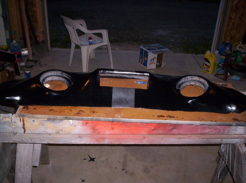

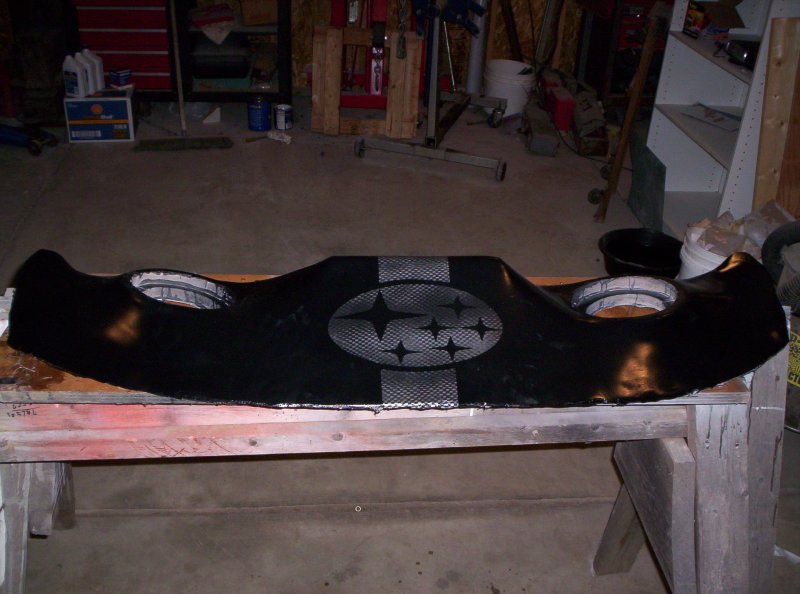

Old Jul 30, 2005 | 06:16 PM
cudaeh's Avatar
Posts: 989
Car Info: 2000 impreza 2.5 rs

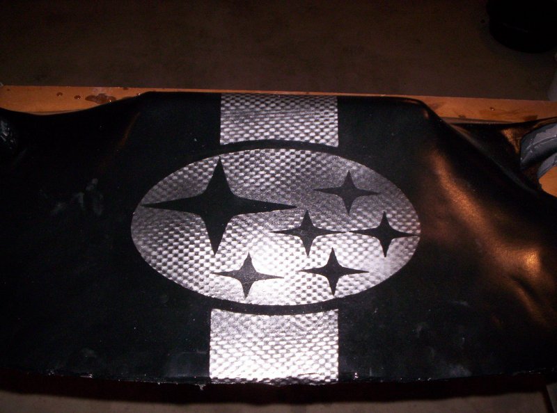

got it smoothed out (best i could) and i got some paint on it... what do ya think?
it looks all lop sided in these pics!!
all thats left to do is clean it, clear coat the poop out of it then start the wet sanding.
Attached Thumbnails enclosure questions??-enclosure-002.jpg   enclosure questions??-enclosure-003.jpg   enclosure questions??-enclosure-001.jpg
Old Jul 31, 2005 | 02:42 PM
cudaeh's Avatar
Posts: 989
Its finished but it looks like crap and I dont have the time or desire to try to fix it.. I didnt spend enough time in the priming and sanding stage so there are still some lumps and warps... maby one day i will fix it and get a good paint job on it but not any time soon ... but it is made and it is a good process to use.. im pleased that i could make it but discouraged that i tried to rush it at the end and it fell appart because of it.

Old Aug 5, 2005 | 05:21 AM
cudaeh's Avatar
Posts: 989
I think my down fall was i did not color sand things between coats... i looked at it the other day and got sick at the faliure... I went to the store to see what i could find to help out... I found this krilon wrinkle finish I sprayed it with that and it did a wonderfull job at hiding the inperfections and looks great now...
I used a "filling" primer after all my putty work... i sprayed the primer sanded it, sprayed it again then shot a mist coat of black to see my low spots then sanded again... i should have done it one, maby 2 more times..
