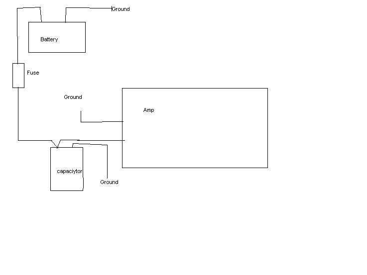

maybe your alternator is bad, it should be putting 14.4 out to the cap when you are not playing anything loud. also, the ps2 doesnt use a whole lot of juice. but it has to run off constant power, it cant handle the drops that will happen if you play bass loud at the same time. how is your cap wired in to the system? right after the battery then to the amp(s).
