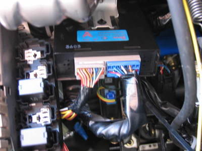

Step 2: Locate the “Integrated Module.” It is about the size of a large turbo timer and has 2 harness’ coming out of it.
Integrated Module

Step 3: Slide the “Integrated Module” down towards you and it should come right off. Once it is off, remove the 2 wiring harness. (Flat head helps with wiring harness removal.)

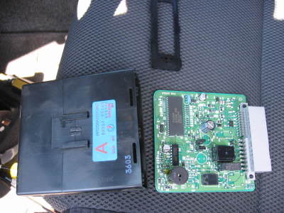

Step 4: Wedge a flat head into the “Integrated Module” to pop off the plastic cap piece. Once it is off, hold the grey wiring harness connecting piece and carefully pull. The green mother board looking chip should slide out now.
Integrated Module with cap popped off

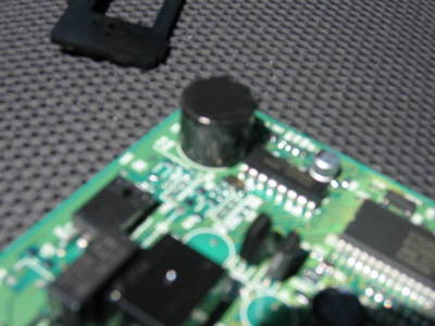

Step 5: Use electrical tape to seal up the speaker. (I am not too sure about how to remove this speaker, so all I did was tape it up.)
Speaker Sealed up with tape

does the tape silence the chime completly? or is there still a little ringing (only made quieter).
Old Sep 1, 2006 | 04:45 PM
WRXakaBooSTi's Avatar
Posts: 1,089
Car Info: Subaru?
its still there, but pretty faint. i dont notice it anymore.
