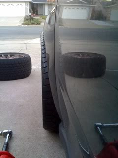

found more room= more rubber yay! smaller rolling diameter= no more fender liner rubbing and dropped lower!
285 vs 275
fronts need much shorter springs and some camber plate and bolt adjusting in order to tuck this much rubber. fronts aren't completely bolted on in the pic (hits spring perch). rears are a whole different story...
all wrapped around CCW full black anodized face and lip 18x10s in two different custom offsets front and rear

275 vs 295
275s on 17x9 weren't enough. so i went with 295/30, 18x10 mock ups. stock body

damm, that wide..ill check it out in the weekend if im free, ill let you know

the wheel bearings are going to hate you!
not really considering the width of the wheel and the backspacing. offset isn't everything...
