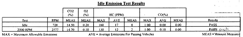

Went and got smogged on e85.
If you could fail for emissions being too clean I suspect I would have.. The two smog techs working on it kept saying "Soooo clean???"..
AFR was about as dead nuts stoich as I could make it for the two idle speeds..
Catless up-pipe.. Exhaust was from an 03 with unknown mileage..
E85 ftw again....

wow no co2!

Originally Posted by azer408
I wonder what someone would push out running 91 and like 2.5 gallons of e85....
All that does it leans you out..
So for a 2 speed idle test it'd help - for a test on the rollers you'd likely fail.

Yah - it will lean you out / may aid in passing if your tune is off.. As long as you aren't testing NOx it helps..
If you aren't AWD and you use too much the high combustion temps from leaning out will increase NOx and could cause a fail..
The reason it helps just has to do with leaning rich cars out - not really burning cleaner..
But in a straight e85 car - it does burn cleaner as well
