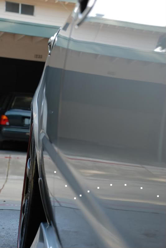

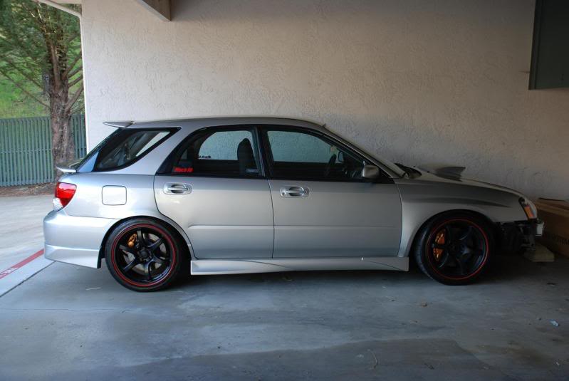

finally took a picture worth showing.
Note to self: get a nice wax/claybar job done. Get different springs for the front or upgrade to coilovers.

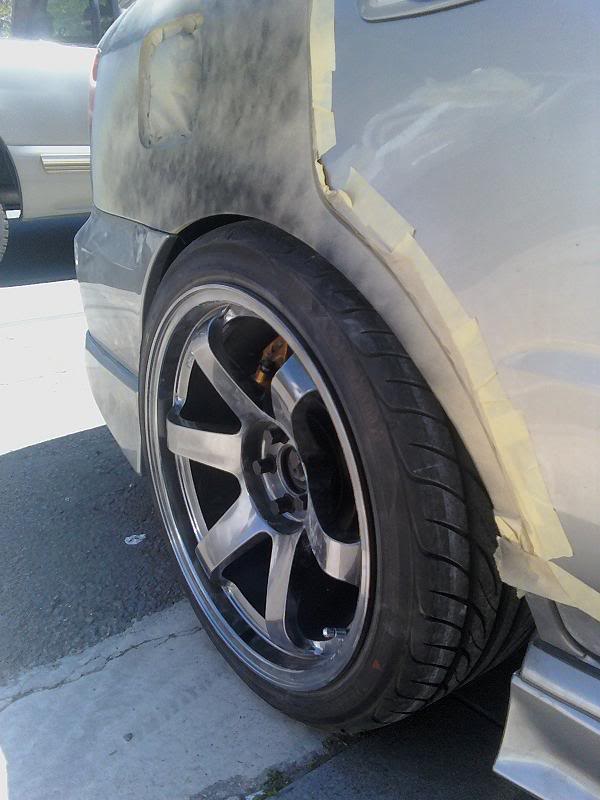

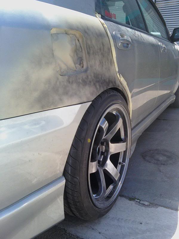

18x10 on wagon fenders ! almost done.. they are still working on the fenders. Thats a MAJOR pull... a pancake flat roll and a little flare to the fender. First pic you can see how off the bumper is... it shows how far the fender is pulled. The second pic shows basically no camber... so of course with some camber its gonna fit just fine

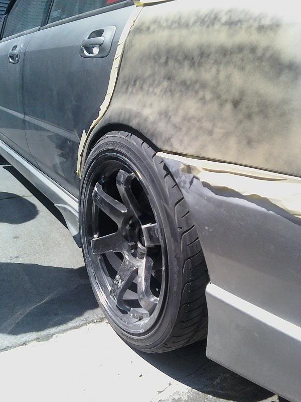

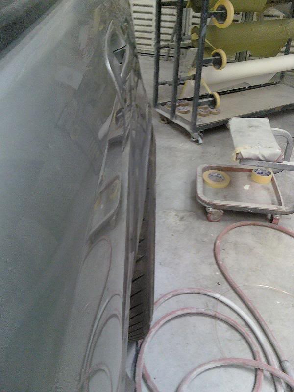

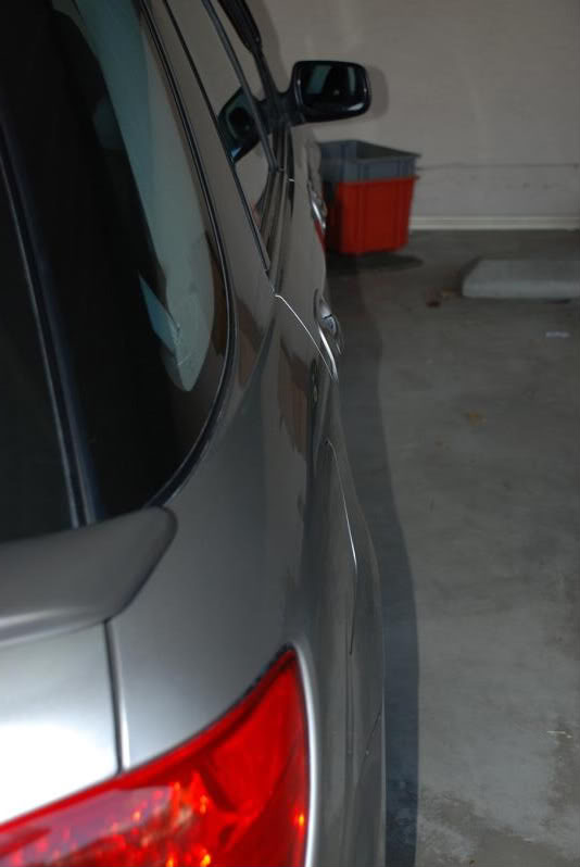

bump for the sexy wagons out there.... well heres an update ... heres my quarters... rolled PULLED then hand remade to look stock... so its about an inch wider... and has the exact same body lines as a stock quarter... what do you guys think... by the way thats an 18x10 +32 tucked in the rear ... with an 18x8.5 +45 up front

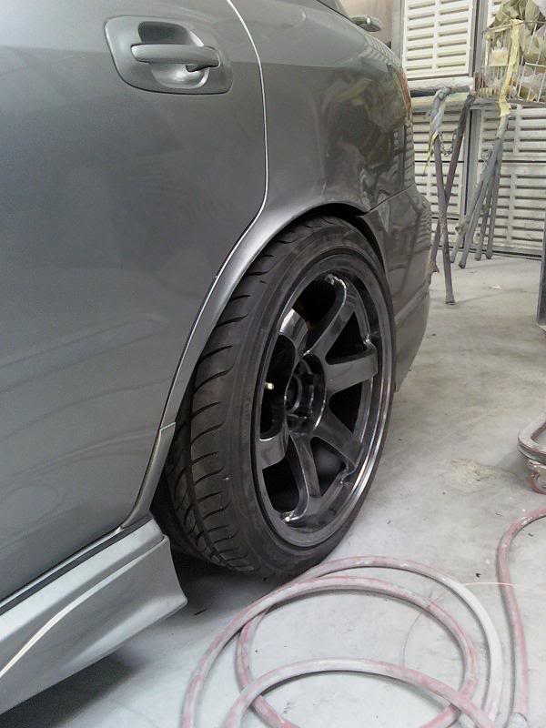

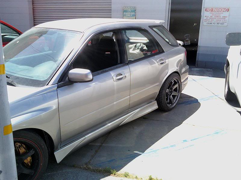

almost done... tuckin 18x10"s on custom fenders.... alignement tomorrow

^ hey shagon that rear fender work looks really clean. where did you get the work done? they did a great job.

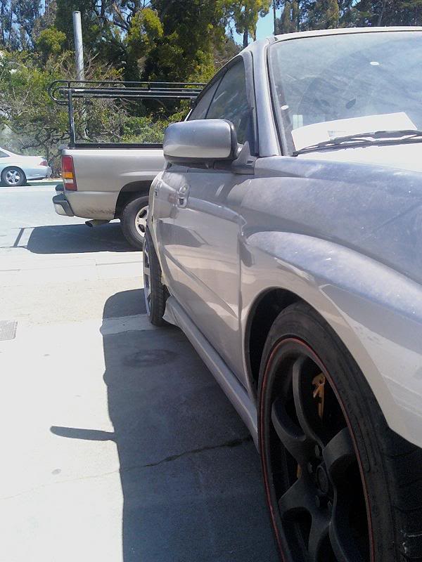

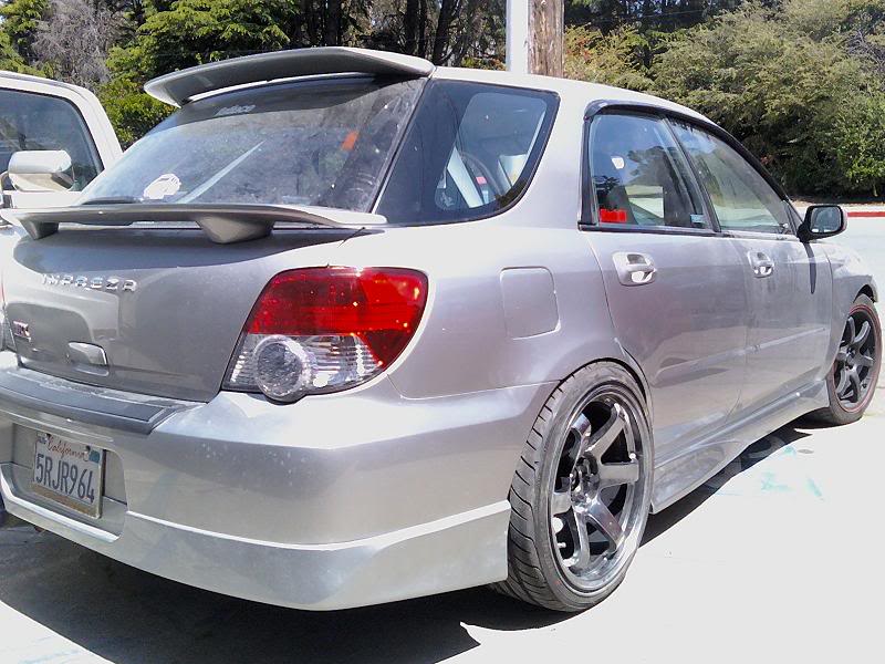

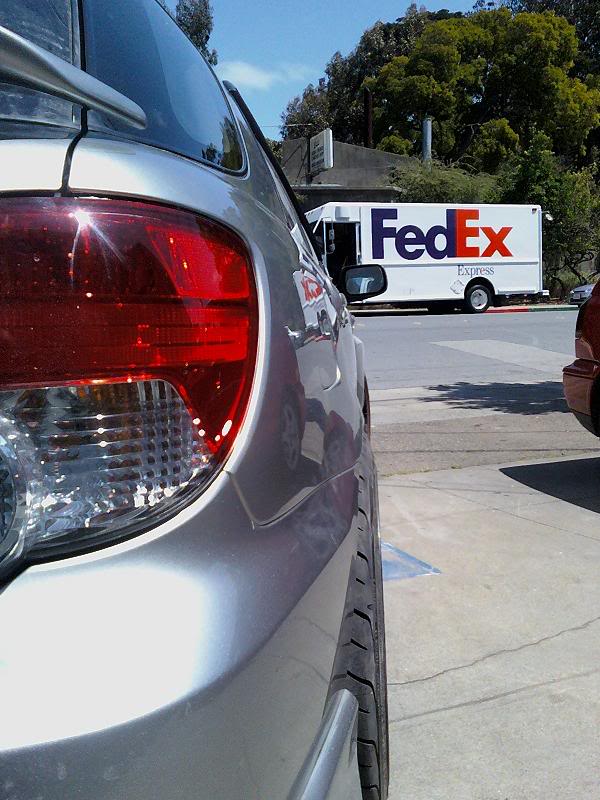

Cleaned... and finished product ! alignement and real rims go on thursday ! here you go, new pics.. Yin.. the rear work was done by Image Auto Body in Colma. They do AWESOME work.
