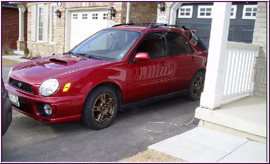

Hey all,
Just wanted to post a pic of my 02 with bronze stockers on.
Let me know what you think!
Cam

wow, those look very nice for a "do-it-yourself" job, what brand spray is that?
Old Mar 20, 2006 | 07:49 AM
mr. tickles's Avatar
Joined: Nov 2005
Posts: 38
From: Milton, Ontario
Car Info: 02 WRX Wagon
The paint is duplicolor bronze.
I think it was like 8 dollars a can x 2 cans.
Cam

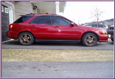

Here is another shot from the side.
Cam

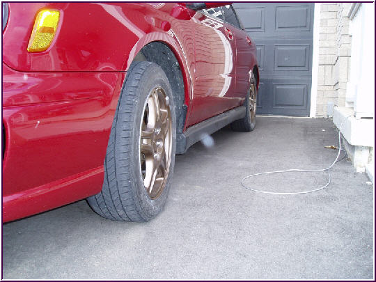

I have a close up picture here, but it is from an odd angle.
1). Take wheels off car.
2). Cleaned the rims with soap and water, then with simple green. Then rinsed.
3). Next, I wet sanded with 400 grit sand paper.
4). When all the shine from the clear coat was off, I cleaned the rims with some isopropyl alchohol.
5). I then masked off the valve stems and tucked some envelopes between the rim and the tire.
6). The next step was to coat the rims with 3 coats of self etching primer.
7). After the primer, I then coated the rims with 4 coats of the duplicolor bronze.
8). Next, was 4 coats of duplicolor clearcoat.
BTW, with the exception of the self etching primer, I left 10 minutes between re-coating for the paint and clear coat.
Let cool then serve.
Cam
