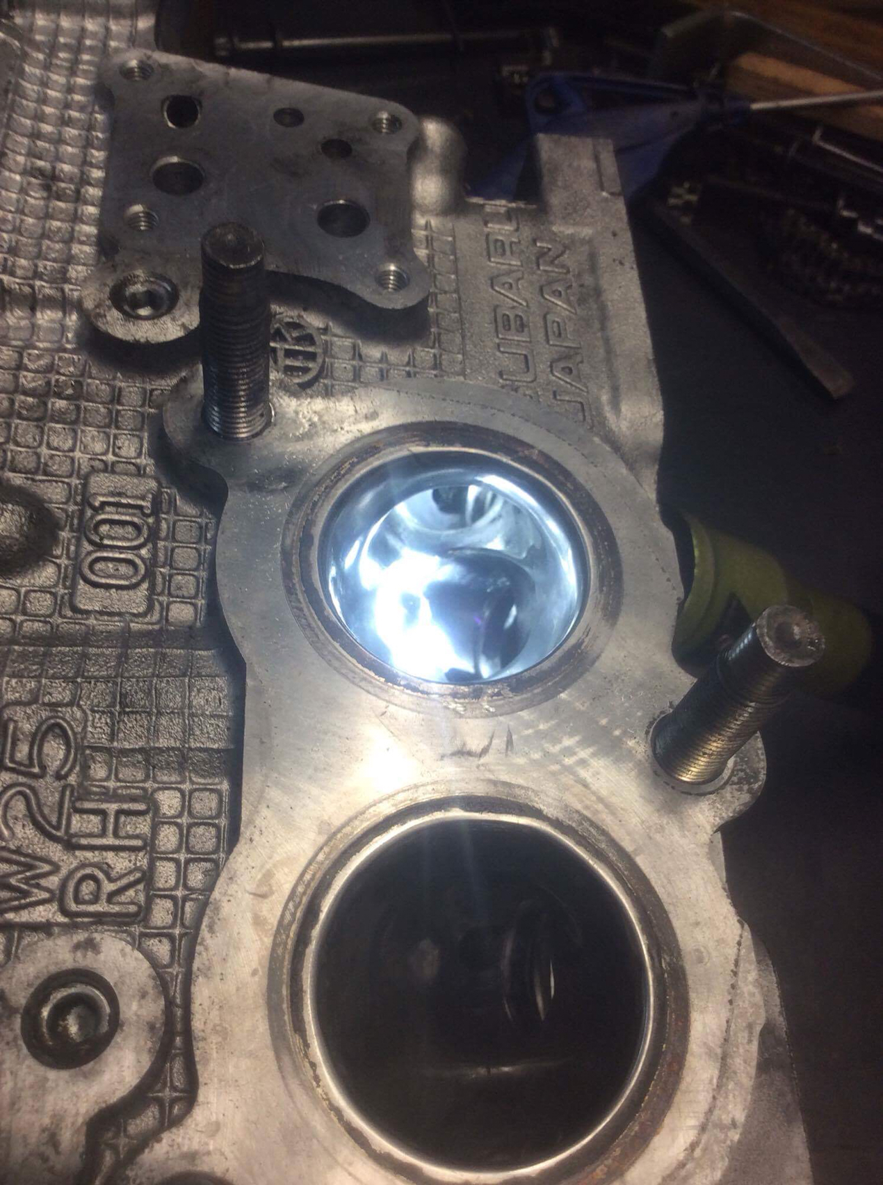

Earlier this year, I started to get some bad stumbling and instantly knew something had gone wrong. All hoses were connected however, as soon as i opened my oil cap I knew I had some bad blow and the rings had gone bad.

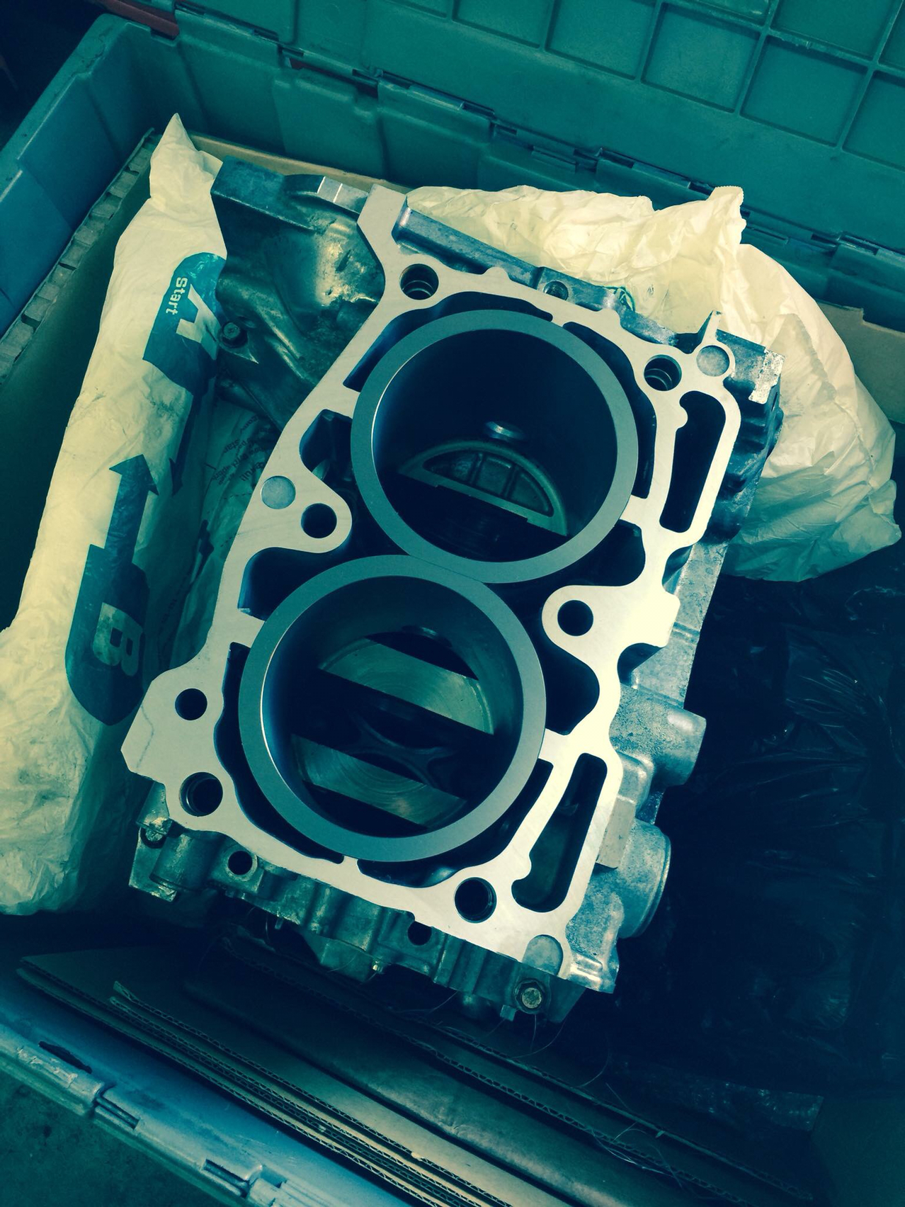

After discussing with Mert at RBMS, we knew what the next step was and started to create a game plan. First Mert urged me to sleeve the block and thats where all the fun began
As far as the build goes:

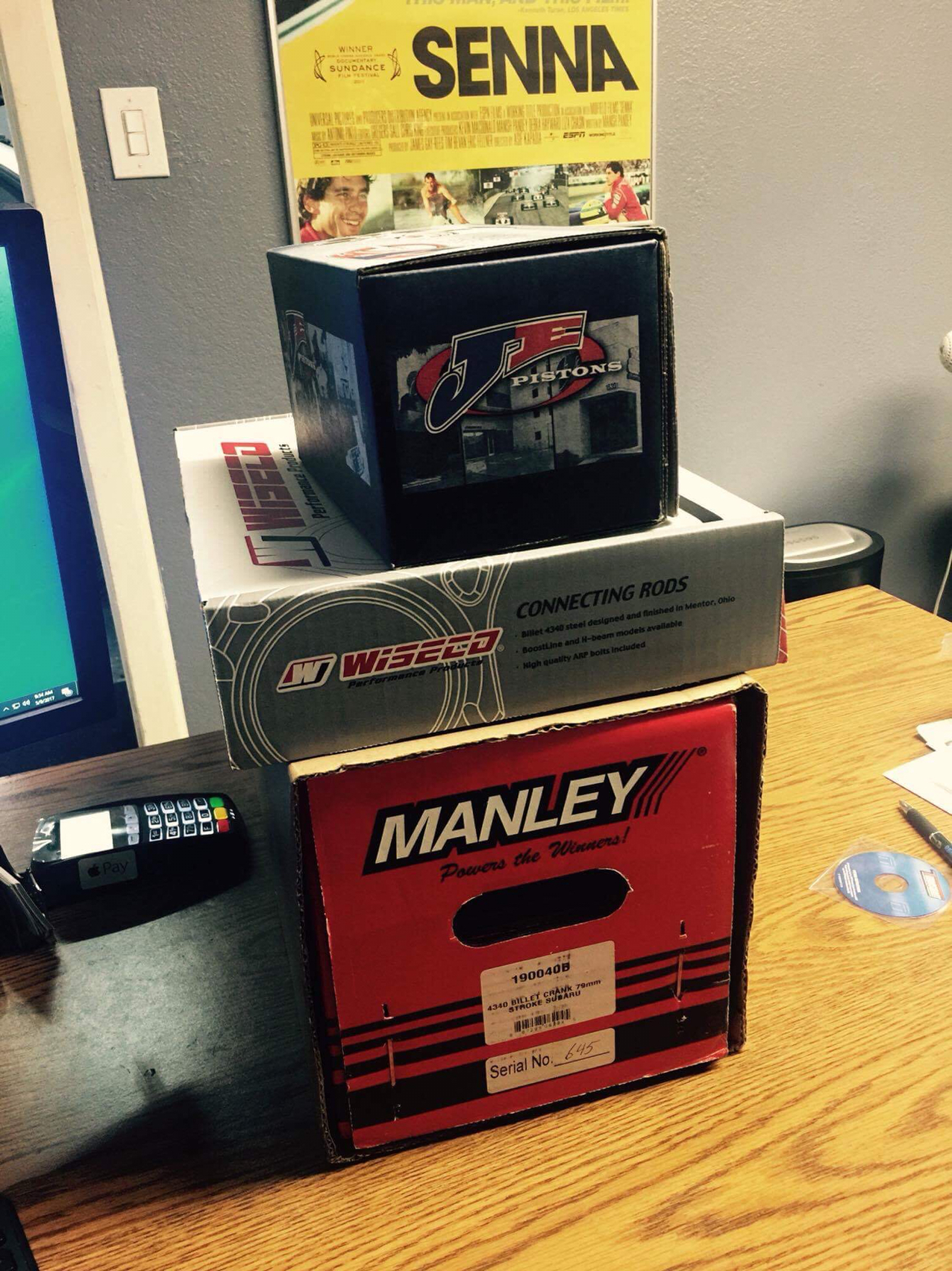

Shortblock:
EJ25 Dry-Sleeved with Darton
JE 99.5mm with 8.5 compression
King Bearings all around (stock sizing)
Manley 79mm Billet Crank
Wiseco Boostlie Rods
Now, I had no intention of upgrading the crank to a billet crank but that will be explained later on.
Heads:
Cosworth S2D camshafts
ARP 625+ Headstuds
GSC Beehive Valve Springs
GSC Intake and Exhaust Valves +1
GSC Intake and Exhaust Valve stopper
Port and Polished by the one and only Winston Bautista over at RBMS

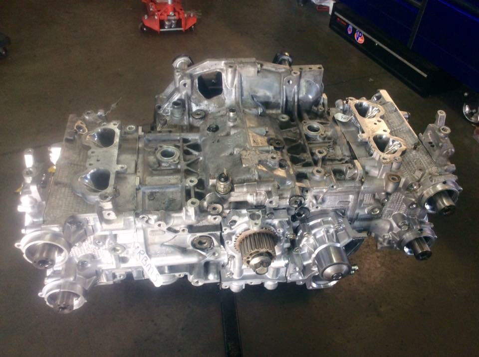

Annnnd shes back girls and boys! Few more things are still on order like a killer b oil pan.. some nice fittings... Blah blah! Enjoy!
Joined: Apr 2013
Posts: 1,911
Looks like it's finally time to start her up! I went ahead and picked my car up from RBMS (Mert and Winston are awesome!!!). Drove it nearby the neighborhood and worked out all the leaks after a drive. Once everything was tightened down, I went ahead and drove it home for break in and just in time for BAM! Man oh man, does it sound mean and deep.. you can definitely hear the cams on idle. After 1500 miles of break in... It'll be time to install all the goodies, go speed density, and truly give the motor a run for its money.
