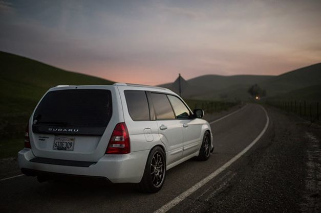

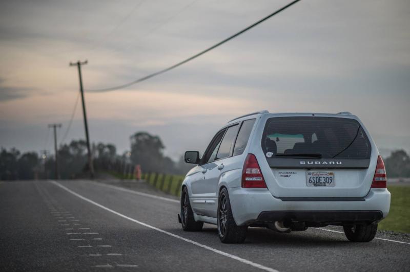

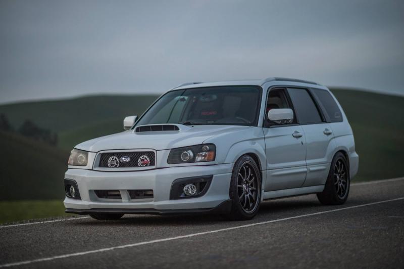

Recent pics taken by Scott Fong!!!

Such a clean FXT. I like your style sir !

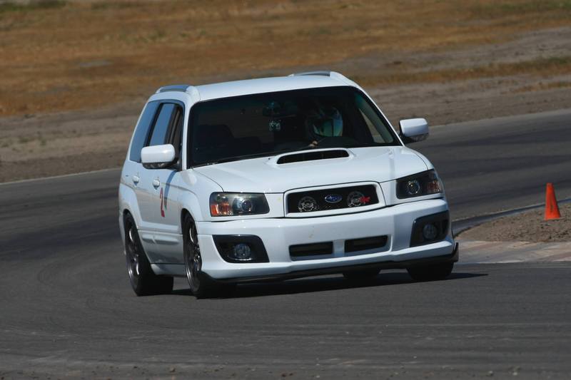

Also just had a track day ButtonWillow Raceway. Had a great time.
