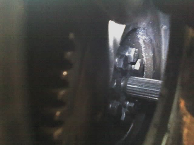

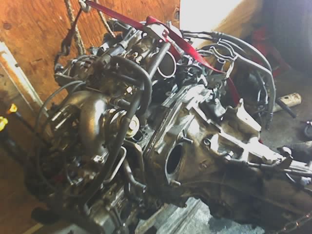

I have some pictures.
First is the EJ engine w/the EA tranny test mounted together.
The second is a pic is from the starter hole showing the tranny input shaft seated correctly.
