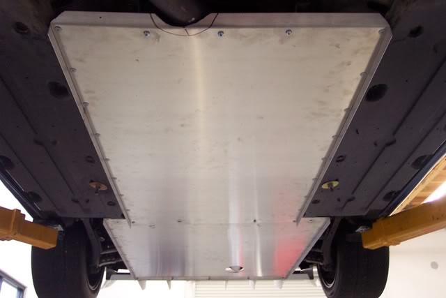

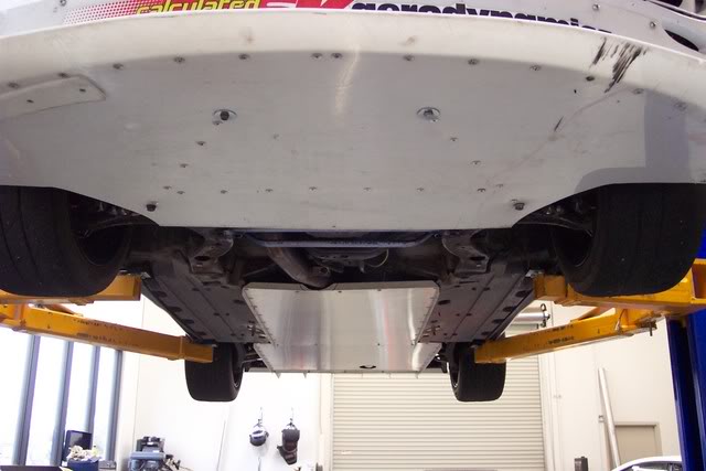

Update: Flatbottom Completed
After the last track, event we decided that the car really needed to have the flat bottom completed and we had to do something about the gold wheels that now looked totally out of place on the car.
Calculated Risk has been extremely busy, but the day before the event they were able to complete the full flatbottom on the car. Having never driven a car with a flatbottom I was not sure what to expect, though after the first high speed corner I knew it was entirely worth it. We decided to leave a small gap in the under tray to make sure we were able to vent the engine bay properly. In the future we may decide to find another way to vent the engine bay and seal up the entire under tray. Really the flatbottom in 90% complete. We are going to be adding naca ducts to the rear diff, and come rear brake rotor/hub coolers. We will mostly likely be adding a transmission cooler with its own naca duct as well.
In slow speed corners you would be hard pressed to tell a difference, but in medium to high speed corners you can feel the difference on the car. The faster I went the more of a difference the flatbottom made. You could feel the car becoming more planted as you increased speed, it was fantastic.
Here are some pictures of the belly:
Rota was also kind enough to send of two sets of Torque wheels in a 17"x9" rim with a 30 offset. Unfortunately I don't have any pictures of them at the moment as we are trying to work out fender clearance, but I will get them up shortly. The wheels give the car a much more aggressive stance, and the dark silver color works with the cars scheme.
