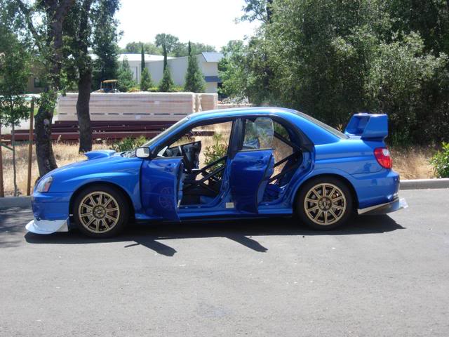

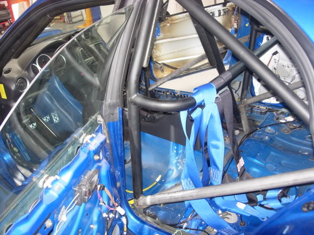

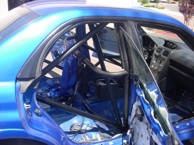

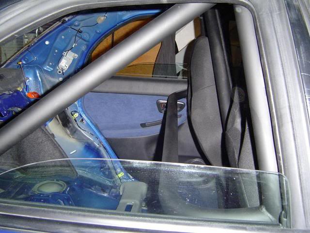

The Lock brothers, Brian and Mike, built roll cages and their work was exceptional. I decided on getting a roll bar put into the car. The name of their business is CalculatedRISK: Racing Fabrication. After talking longer to Brian he convinced me that putting in a full cage was a far better decision, especially if I knew I was going to be taking the car to the track as much as I did. At this point in I was really only driving the car on a few weekends; mostly only for track days. I said, “What the hell - build me a full cage.”
The Cage:

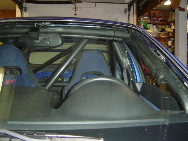

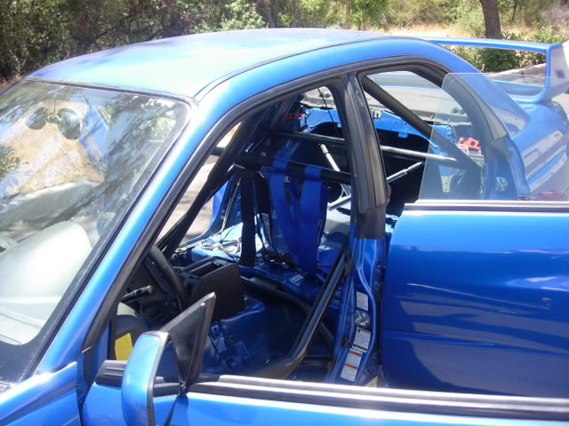

They built the cage in two stages. The first stage is what is considered a NASA minimum roll cage without the door bars. I chose not to do the door bars to begin with as I still had stock seats and wanted to keep as much of the interior intact as possible. After I talked more with Brian I also decided to have an extra bar welded in to help with reinforcement and bracing.
A week later I had a cage by CalculatedRISK for my car. The cage was flawless, and everything fit together very well. It was necessary to remove some of the interior, but most of that was in the rear, where no one would be able to sit because of the cage.

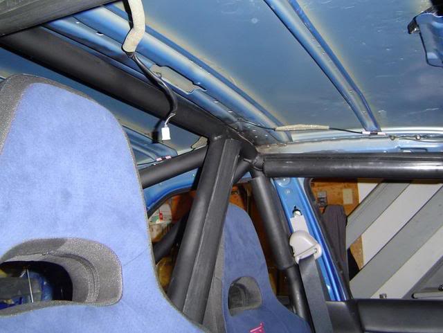

After they installed the cage I immediately felt a difference in the stiffness of the car, even on the street. The car felt like it was more stable. Soon afterwards I went to some more track days, and the cage made an even larger difference on the track. You also really do feel safer being surrounded by large metal bars rather than just the car shell. Spending money on my safety is probably the most intelligent investment that I could have made.

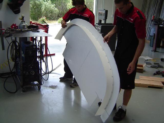

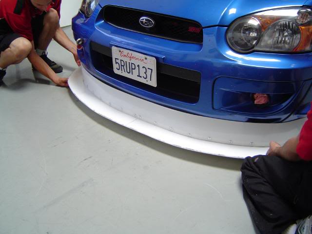

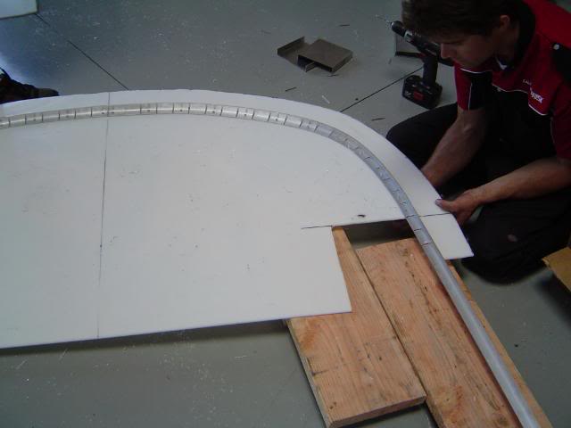

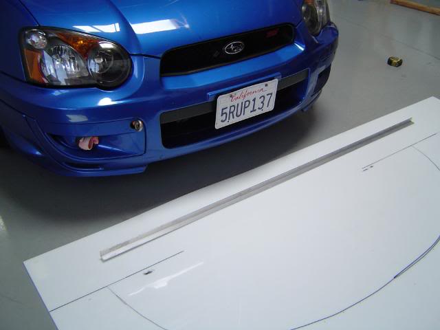

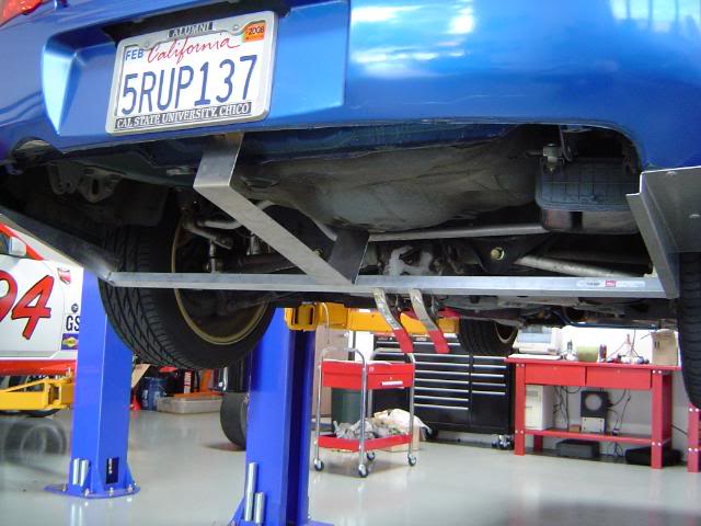

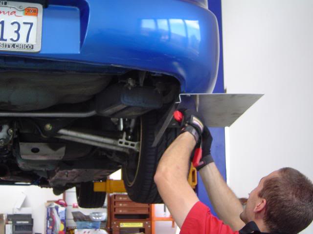

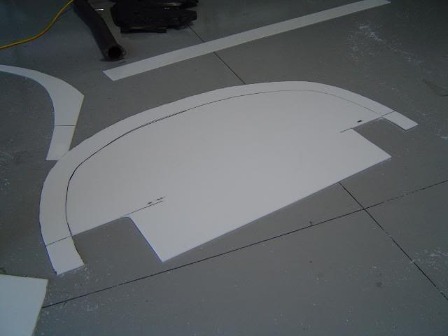

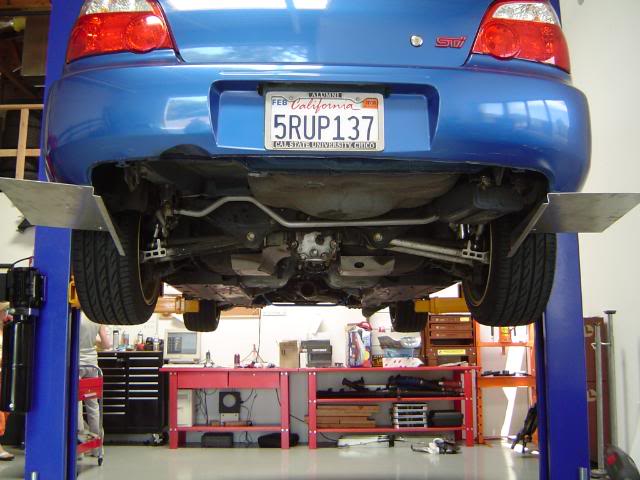

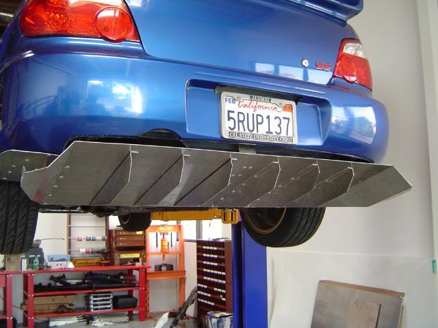

Next we decided to do the splitter.

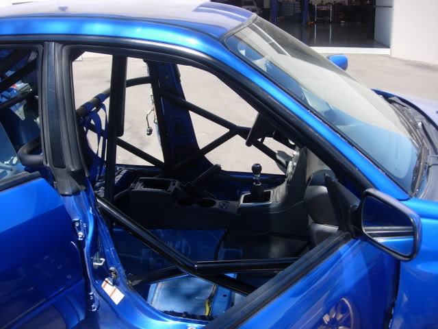

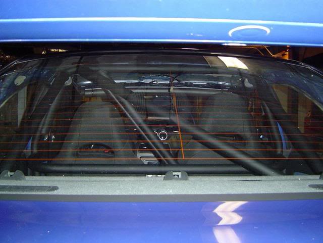

Finally the cage was set to be finished. The door bars were to be finished and integrated into the B-pillars. A floor bar was put in and integrated with the tunnel, an integrated rear strut bar, and two diagonal bars in the rear were added as well. At this point the cage is completed and is a sight to behold in person. While the pictures do show a lot it just isn’t quite the same as looking upon this jungle of metal with your own eyes.

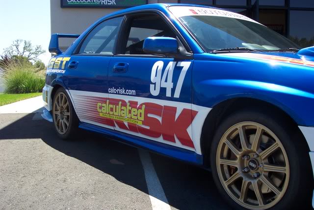

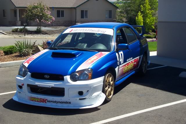

Completed Car:

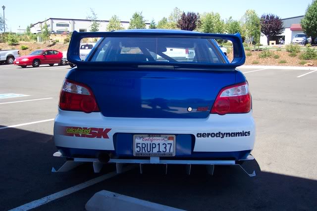

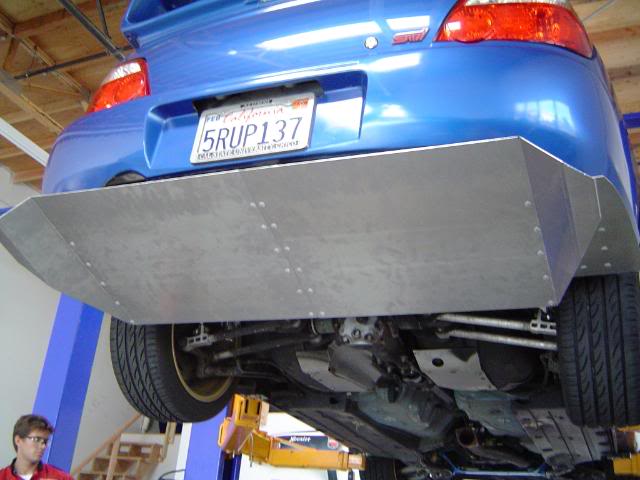

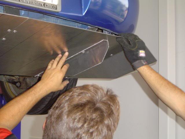

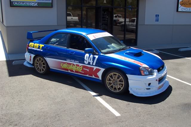

The aftermath has been incredible. The car no longer gets light during high speed turns and drops. It is absolutely glued to the track. Sponsorship or not, the diffuser and splitter have increased my confidence in the car, feel, and pure outright grip. I can never see driving the car without them again.
I’ve done two NASA weekends since the work has been completed and the car feels fantastic. It still needs some suspension tweaking, but the car is almost set up perfectly. At Infineon raceway Brian Lock and I took turns driving the car. I was in Group 4 and he was running it in Time Trials. I was able to run a 1:55.9 lap and Brian was able to run a 1:52.9 lap, not bad considering the difference in our experience levels. This is also with not all the weight taken out of the car and including a passenger as well. Pulling these lap times with a car weighing nearly 3700lbs is an impressive feat. Brian and I took turns being passengers with each other and frankly, it’s scary as f***. When you get to the point where you can feel everything the car is doing: the slip-angle, the lateral grip, the braking ability, and you know how close the car is to the edge, it becomes a different experience to be a passenger. I now understand why the Locks aren’t always thrilled to come on rides with me anymore. At least I know I am picking up some speed.
For now the car is set up very well. A larger turbo may be in my future, but I still need at least another year to fully master the power that I already have. When I decide to go that route I will be consulting heavily with GST Motorsports to make sure the route I decide on will give my car both strength and reliability.
Later this year I will be running in the Redline TimeAttack series, street class at Laguna Seca. Depending on what I decide next year I may run in the WORKS endurance series racing events here in Northern California. The possibilities are endless and all will be fun.

Is that splitter made of alumalite?

no offense... im sure it works great... but that rear diffuser... it looks like it was built by a high school shop class. take this as constructive criticism, with the the quality of the other work done on the car it could and should be better. it might be worth looking at for a redesign

i like the random "aerodynamics" sticker on the back...its like when cars say DOHC...for like 20 years straight
but yeah looks awesome, needs skirts
