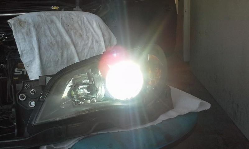

headlights, brackets, ballasts are in!
by far the BEST $60 ive ever spend on parts! yes, 60 smackers!
02RS25's bugeye to hawkeye swap-10470808_10154519191695174_2318320863299543858_n.jpg
bumper will be in tomm, and hood hopefully next week. Still waiting on core support

07 STi bumper is in! very special thanks to Apetron!
Also, thanks a lot Phoshizzle for coming by and explaining this rat's nest of wiring for headlights and how each bulb reacts with 02 harness! hawkeye angel eyes, halos, and high beams wired! Onto turn signal and parking lights

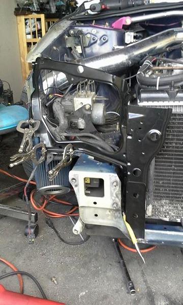

Some more progress! Buckets, tie bar, fenders mocked up. Ran into some issues with clearance with the buckets. Most people when doing the 07 swap cut away at the top tie bar. since my entire core support was borked from accident, i decided to just install 07 parts from the get go. SkizzDawg was awesome and let me poke around his 07 with bumper off. Noticed chassis is a bit different where bucket spot welds to. VERY different. With some measurements i took, im going to try and reshape corners of buckets where they dont clear. Other than than, headlight wiring is all done and finalized (soldered, heat shrunk, taped, tucked, and retained all connecters right at rear of headlight for hassle free headlight R+R later down the road)
This week i hope to have everything spot welded and lined up. After that I can take off the front end and get it ready for paint! BRP While its getting paint, ill be finishing quad tips and custom diffuser
