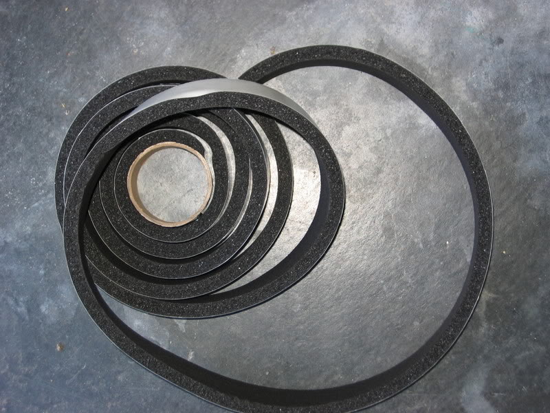

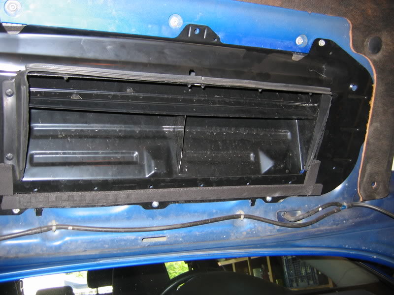

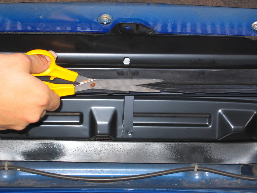

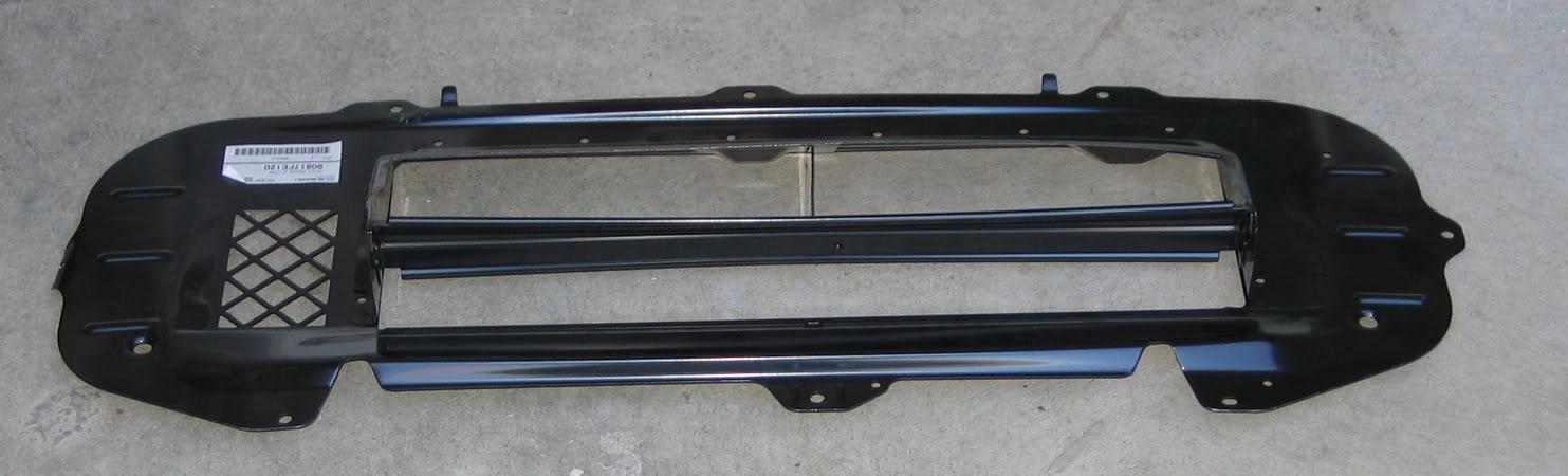

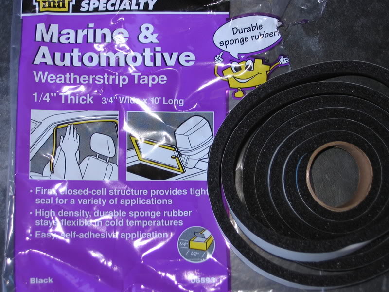

v7 splitter works very well, however when I trimmed the rubber, it was pressing against the fins too much (I could feel the resistance when closing the hood).
I went back and forth refitting and trimming, but the TXS intercooler sits VERY close to the scoop.I trimmed the rubber shroud to fit the front and sides and used the
auto stripping tape at the back. It fits PERFECT. No wind howling, no hood closing resistance and no bent fins. I dont care if it looks ghetto it works!
You can see the imprints of how close the ic sits to the splitter.
(Im very surprised how it auto stripping holds up to the heat).

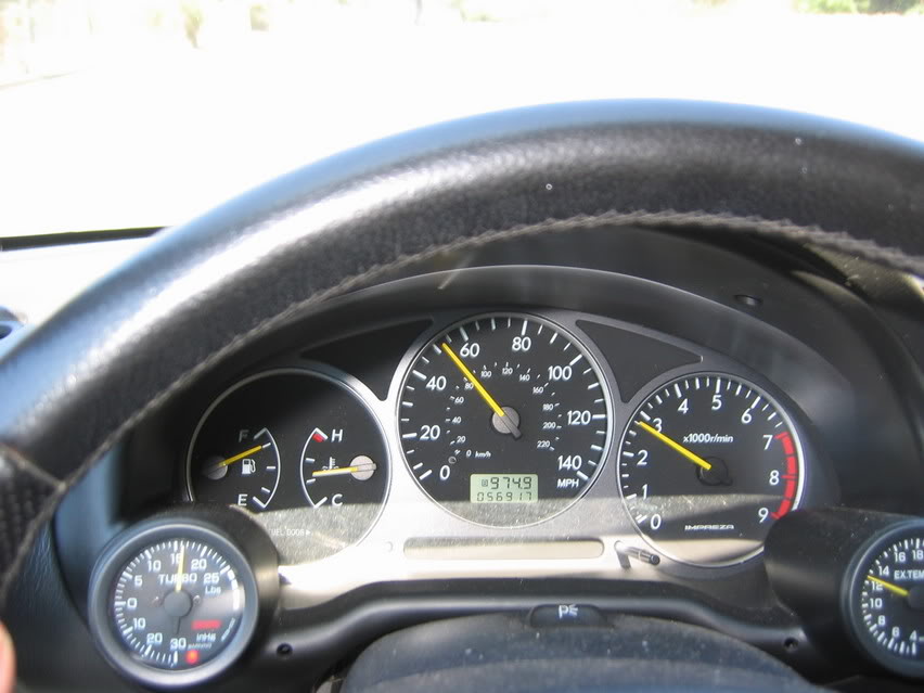

Thanks! I got the guages and autometer replica bezel from J-Spec tuning....I also got my painted scoop from him.
Here is a pic of the guages in action -- gotta love 16-18lbs of boost by ~3000rpms

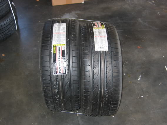

New rubber
Got some new Bridgestone Potenza RE050A's.
Cant wait to put these on...gotta fix my alignment first though
