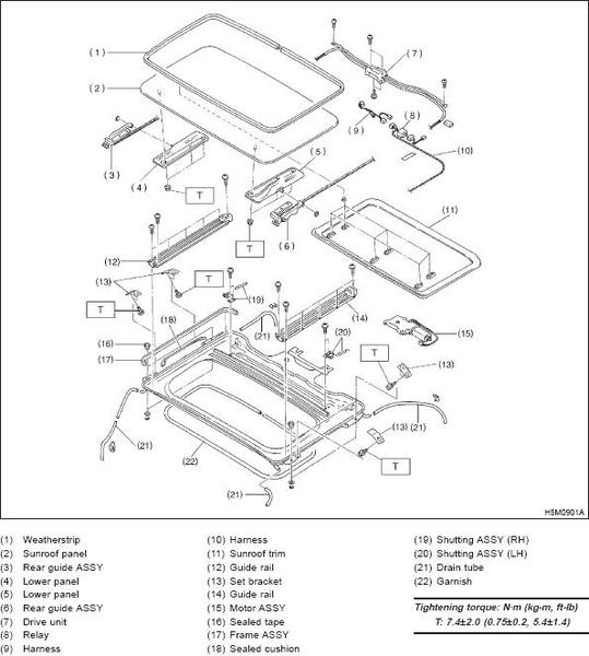

for the 99rs, if you open the sun roof, here should be a drain hole by the corner towards the rear. the drains to the rear quarter panel I believe. you should be able to see the clear rubber tubbing by the floor jack.

if you take off the headliner, you'll see something like the first pic, where the yellow is the drain tube. second pic is just the complete assembly of the sun roof, and 21 is the drain tube...

it's a single tube from the sun roof to the trunk...
